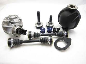

G-Force has had a great product. I have posted before that on my daughter SRT8 2010 Challenger my husband had the G-force axles and driveshaft installed by HHP back 2014. There is a Life Time warranty and we have not had to use it. As I have posted before I think their product is good for her level of racing with a D1 Procharger build racing 11.50's or 11.00s.
The problem with G-force as competitive as they might want to be, there are not enough Hemi racers who are into the 8's running their stuff.
6,331
41,253
Racing 8's is a Race Car build and needs strength and safety.Our Hemi's carry more weight and have a lot of power to put down on the ground. The back end always needs to be built for strength and then go forward!
My Husband as some of you may know was Top Cat. He was heading for the 8's and knew from modifying my prior SRT8 2010 Challenger and had one of the 1st DSS 9 inch rears installed was needed. But guess what the 1400 axles broke so many times Frank gave us a set to keep on the shelf.
I Think DSS continues to step up to the plate from racers giving them info to make a better product!
But If G-force does have this product.
G-Force does have this!

The driveshaft shop also has improved on the https://highhorseperformance.com/th...t-challenger-srt-srt-hellcat-6-2-6-4l-manual/
When purchasing this kit then you would also have to decide, if you want a carbon fiber driveshaft or an Aluminum one. John had chosen Carbon fiber for weight savings and
I spoke to Frank a while ago ( he is retired now) about the CF and he said it is actually stronger than the AL vs most people thinking it is not. He said they apply an extra coating on the outside of CF for protection.
From when John had the 1st DSS 9 inch kit installed for his Top cat ......... this new version, I know he would be installing the new kit for strength. I think John would not gone past this like he did with his Mopar Drag Pak. On his DP he had it Back halved for the wider drag wheels. It was done beautifully. It already had the solid rear axel.
I know he would have continued to build his DragPak vs Top Cat....but then again knowing him he would have been building both! :cool::cool::ROFLMAO:

Ok here is the Top of the line combo of some friends who race their 8 sec Hellcats.
https://highhorseperformance.com/billet-hellcat-differential/
And the DSS Axles and halfshaft 😎

#56
Did you buy direct?
That rear may be my next purchase. I like that I get to keep my axles and braces. Plus the added piece of mind that my diff isn’t going to explode on any given launch.
