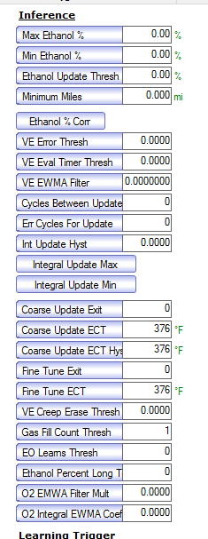

Keep in mind different tuners do some things differently, so there is not necessarily only one correct way of doing things. I personally am not a fan of inferred flex tunes, so we do not do them for customers. I realize tuning information is "hush hush" with the hemis, but the just of it involve installing a software patch then there are a lot of changes within the flex fuel tables that have to be modified.

Here are a few pictures of a non flex tune so no values are entered. But maybe this will help give an idea of just a tiny part of what is required to make the flex work.
