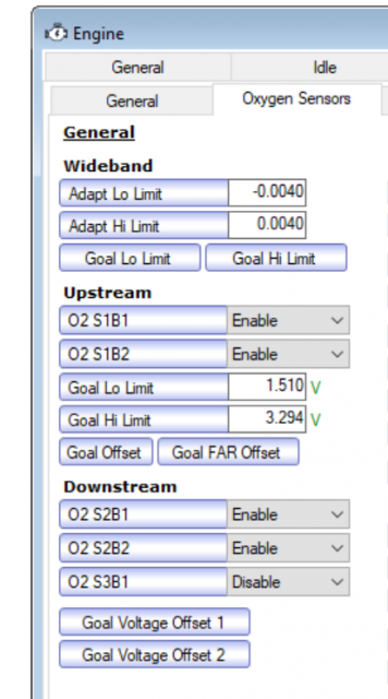

Spent some down time during the holidays to play with my flex fuel tune a bit. I'm still seeing positive fuel trims, so it must be expected for my model year. I'm seeing some items in my tune, as well as a stock 2016 Hellcat tune, that are modified to understand ethanol in 2018 and don't exist in 2019, and 2020 stock tunes I have that I think impact the trims.
These variables are in the stock 2016 Hellcat tune and not in 2019 and 2020. In the 2018 tune I have it's a table with ethanol % down the side rather than a fixed numeric like below.

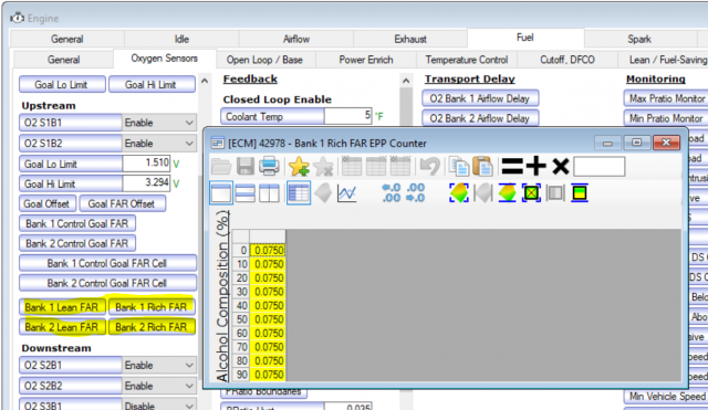

I've now gotten my alcohol calcs to within 8-10% on Shell 93 consistently, I tested 4 times. On ethanol they're within 2%. I'm finding the sweet spot for me is in the E70 to E75 range to get max power and reduce the pressure on the fuel system in this cool air.
Some of those values sound vaguely familiar to me. I will have to check and see what I have in my 18 FF tune.
Which table were you peeking at in the 18 tune? I want to say I remember a table with ethanol percent down the side and what the appropriate FAR would be for the given percentage?
Odd that it would be in the carte PCM but not the locked factory. Wonder which OS it is?

It was under the o2 sensor section of fuel.
7,309
19,162

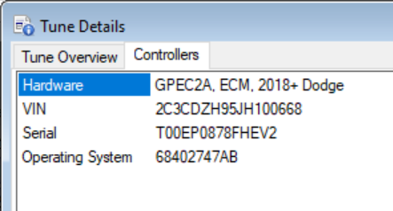

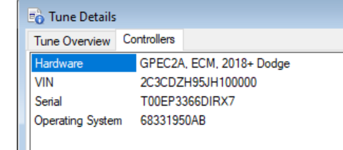

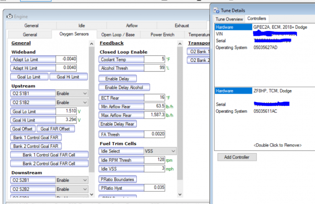

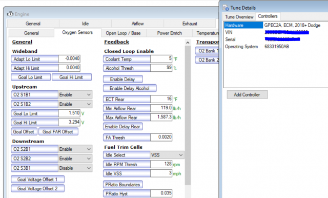

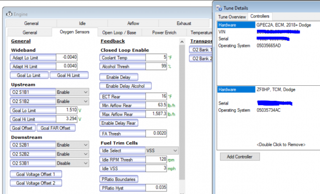

Here's more detail on the differences I'm seeing:

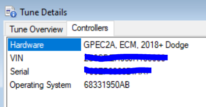

This is the info from a Demon standard PCM. Notice no reference to Rich/Lean for O2 settings. This could have been because HPT hadn't mapped some items yet or something though.

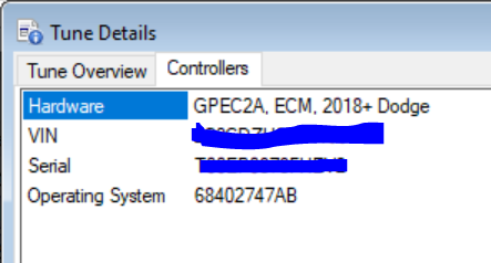

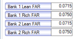

This is from the Demon CRATE PCM. Notice the table for Rich/Lean:

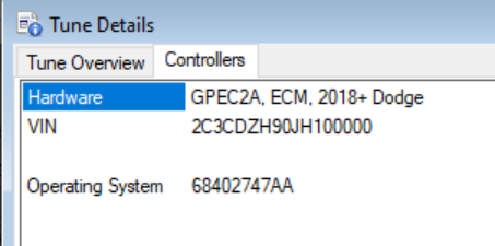

From a 2019 Red Eye factory tune, doesn't exist at least under the O2 section where it was in 2018.
Finally, a 2020 Red Eye which has about half the values under O2 section. No idea why, again could be HPT hasn't mapped them dunno.
