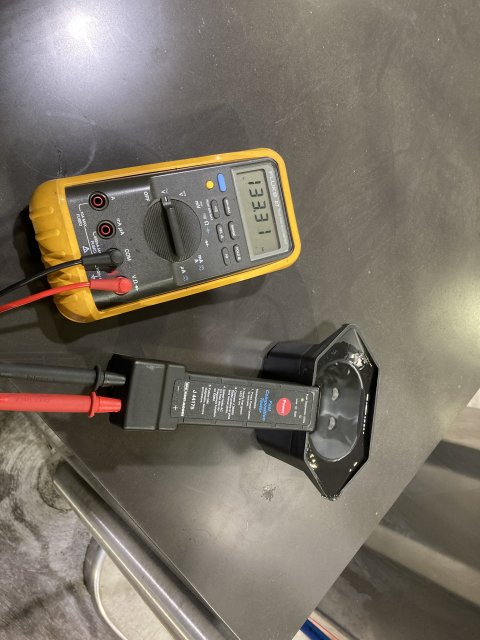

Is that 77.5% tested with a tube or do you have a gauge?
At the moment I am testing it with a highly accurate Kent Moore Digital Fuel Composition tester. Fuel is testing around 81-82 % last fill. It’s a bit cumbersome but it works instantly.
display reading minus 50 is alcohol %
Pictured is 83%E
