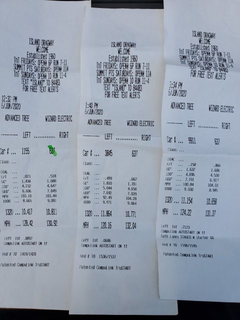

All 3 passes. I'm car 637.
Nice , #3 1.60 60' is good & when you were at 1200 / 1300 rpm , you can try a little higher rpm next time & might do better. And depending on how much time between passes for cool off ? … keep eye on tire psi & adjust as needed to be consistent with psi , the faster or not you make passes the psi will be different.
Also work on RT , shallow stage & leave on the 3rd yellow on tree , that will help RT.

I wasnt worried about R/T since it was my first runs in the boat. Ill work on it once I am consistent.
I actually have about 500 passes under my belt dating back to 2000 lol.
