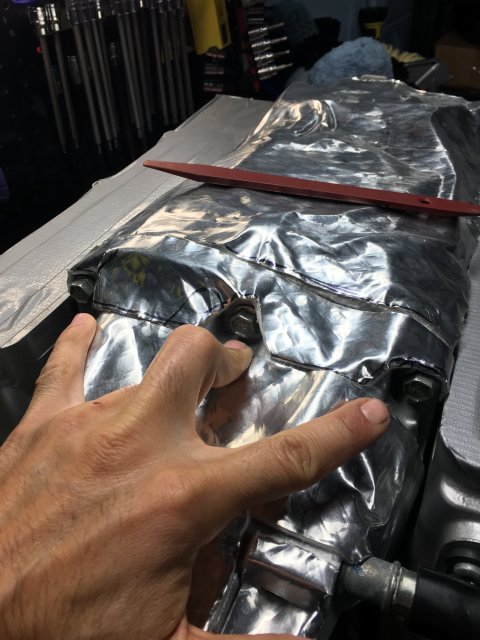

one other tip, I trimmed the heating blanket along the seam where the snout mounts to the blower and I made sure to leave the bots exposed. this way If I decide to do a pulley swap down the road I can separate the snout from the blower without having to remove the heating blanket. Hopefully the pictures will show what I mean.
