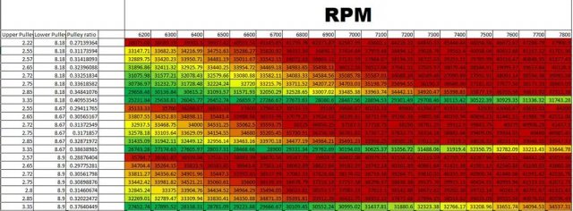

The log doesn't look near as bad as I thought in terms of air charge temp. Yours got to like 153°F which is about where mine ends up when the weather is hot out. I've seen as high as 164 or so if I have to hot lap and I'm on a 2.72 pulley. I do think the 2.5 spins the blower a bit too hard so if you continue to run it, I'd have a plan for bearings etc in the shorter term just in case.
I think the DA is what's holding you back like I think I mentioned before. Every +1,000 foot of DA is worth about 1/10 on ET and probably 1MPH as well. You were at 4500, so that's 4/10 and 4MPH by rough estimate.
Here's the blower efficiency data I have. I think HPindy may have first posted this?
