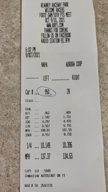

I found some great track prep a couple weeks back and the car was able to launch under full power @ 2000 rpm in first gear. The feeling of hooking up that hard is an adrenaline rush that is going to be hard to beat!
I am still scratching my head at the timeslip though. The DA was terrible (4500+) and I am still full weight (plus my fat ass) but I feel like that 9 sec slip should be easily possible at this level. I am beginning to wonder if the trans has issues as I can't find any other reason for the times.
Any advice from the pro's? ;)

There is a tenth for every 7-800 foot drop. Also what is your race weight?

The difference is the DA. Also, it will help if you can get your 60’ consistently in the 1.4’s.

4500+ DA is the killer. 1000DA and you’d be 2-3 mph faster in the 1/8 and 3-4 up top and be 9.8. DA that high I would stay home lol.

You’re down a few MPH, and I agree, that’s a 9 second pass anywhere under 3000’.
I imagine that’s the only reason you were able to launch under power too, because a good track could have gotten you down to 1.50 with better air, and that’d be your 9.

To the OP...I see your elevation is around 1200 or so? A nice day should give you a DA in the 2000-2500 range easy so I bet you will go 9s later this fall!

Thank you for all the discussion. So what I am hearing you all say is the car is easily 9 sec capable in better weather? Sadly the DA is pretty typical for Kearney NE and that was the last race day of the season so no passes in the amazing boost weather we are having now.
Maybe I will have to try to find a track with better DA and drive a bit further as the wife says moving is not an option! :ROFLMAO:
This is the first time I have been able to launch the car consistently under full power. Apparently the track guys had a big NHRA event a month or so back and the teams with the super fast cars helped teach them how to prep better for the location (heat and altitude). My car stuck all three passes so I kept dialing up the launch RPM and adding a touch more timing on the big end but the passes were all within a tenth and 1-2 mph of each other.
I do have a full HP Tuners log of the pass that I am going to share with Curt to make sure nothing is out of whack on that front.
I have not weighed the car so I can only guess I am at least 4700 lbs given the driver weight ;)

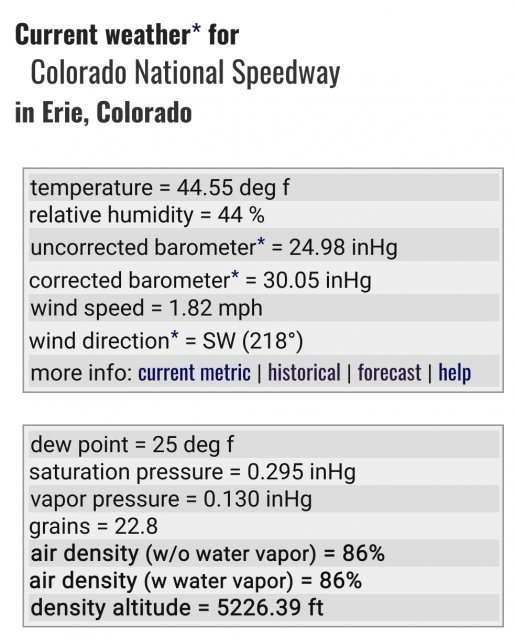

This morning's DA, obviously note the temperature.
