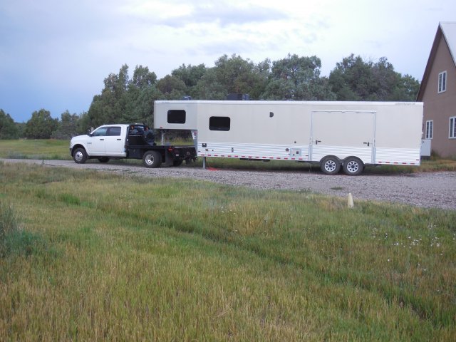

A 20-footer is enough, if using wheel nets and idlers so the tie down ratchets only have to come past the car by a foot or so. Of course, that requires E or L track spaced correctly for the track width.

Well, I must admit that I never took stopping distance into account when deciding on trailer size.
Luckily I have a 30-foot trailer, too. And if that's not enough, I could put a mattress and/or a tire wall at the front of a 35-footer I have.
