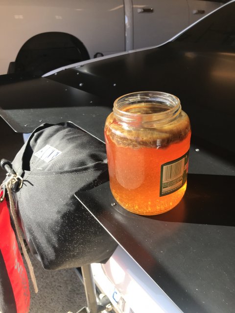

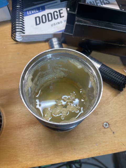

I don't agree with this at all. I'm a mid nine-ish car on a bad day. This is what is caught.
A proper catch can on a Hellcat goes a long long long way especially when driven.

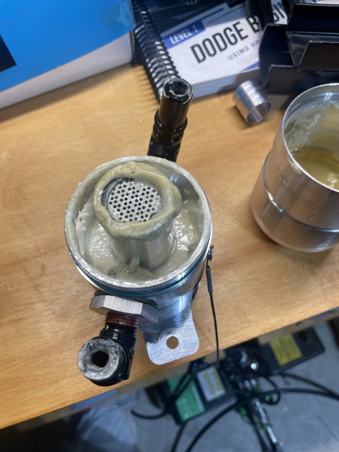

Mine catches "some", but clearly not "all" based on my intake.

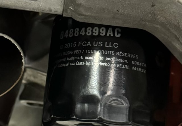

There is a huge difference between the 899 and 041 filters. Just something to think about.

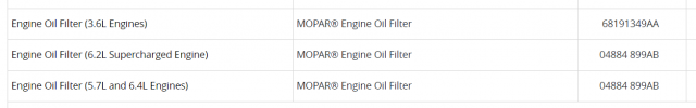

I don't see anything different in the filters other than price and pressure flow. SRT engineers designed this filter for the Viper not the Hellcat. The Hellcat oil pump is vastly different than a viper one. Just so someone can draw their own conclusions:
Factory service manual:
Have your car at a dealership, you're getting an 899 filter.

After buying a couple of 041's with center tube louvers that were barely open or even closed, I went back to the 899 which has holes. Also, micron ratings alone are meaningless. They have to be stated along with the efficiency rating to be meaningful.

One more consideration. The 041 has a dome end bypass valve and the 899 has a base end bypass. When a dome end filter goes into bypass, the oil washes over the dirty side of the filter media.
