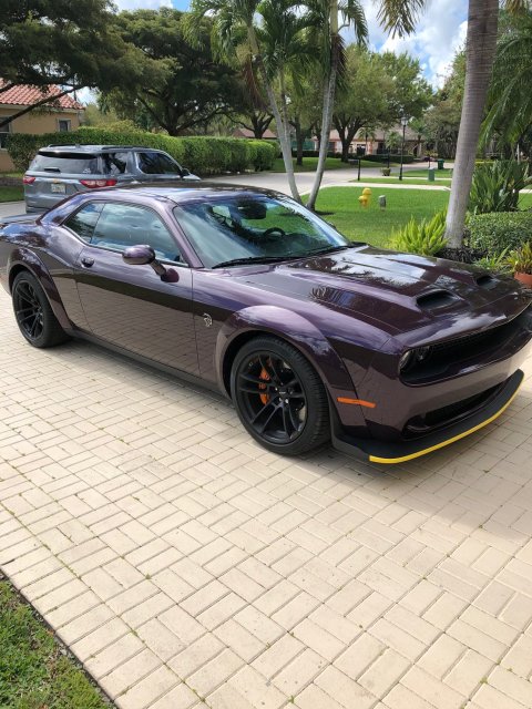

2021 challenger hellcat redeye going to dyno.Completely stock.What fuses do i need to pull if any so everything runs smooth?I heard ABS but im not sure.Thanks IMG_0766.jpg

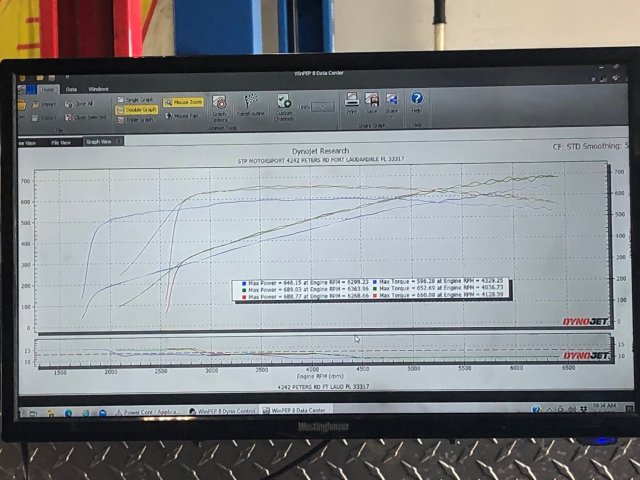

80 outside car was hot first pull 220 after we let it cool down and did much better im not disappointed

all were 6th gear pulls

Nice pulls for sure. Most shops don’t do 6th gear because of the wheel speed in that gear at redline is about 200mph, if I recall correctly.
I think those numbers are much closer to the 'norm' for an 80 degree day at full engine temp. They must'a put a Hellaphant in Eric's car and forgot to tell him. LOL. (I hope my '19 dyno's like that).
@800HP - @17% frictional loss puts you at @ 660WHP on average I would think.
Thanks for posting!

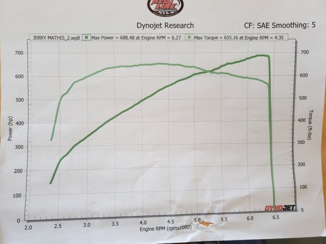

2020MOPARtyPowerAdderWinner.jpg FWIW, my 2019 Redeye made 688 RWHP and 655TQ at MOPARty i Bowling Green KY after a few hours of autocrossing and heat soaking, so these dynos seem to agree what these two Redeyes make. I don't know the DA, but the temp was around 80.
Nice choice! These cars are amazing!

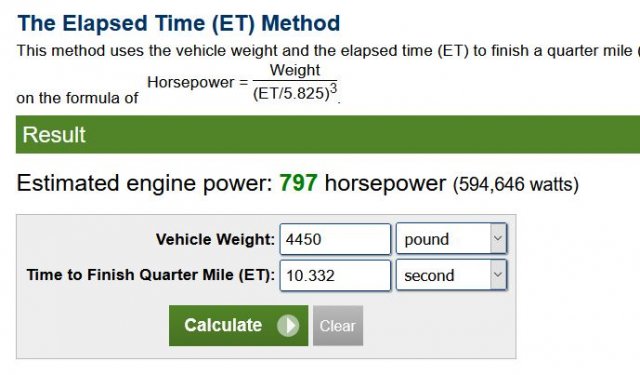

Great pulls. Just for fun I pulled up a flywheel HP calculator and to my surprise it may actually be in the ballpark. What are the chances of this (ET method) reading on a stock 2019 ?. Ha. And when you figure a 15% driveline loss it puts it back to around 680 something at the wheels which looks to be about par. I figured vehicle weight with driver. A little weight was removed, front stabilizer, rear seat, lighter wheels. Not sure what it actually weighs.
