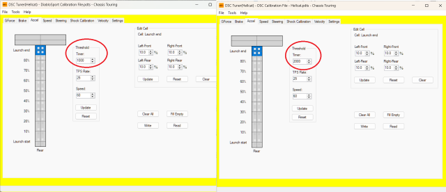

I think it'll be dependent on the setup. Once you hit 60mph or the threshold timer, the acceleration table is done.
So let's say est. 0-60mph - threshold timer = time not in accel table
Hellcat 3.7 s - 1.5 s = 2.2
Redeye 3.4 s - 1.5 s = 1.9
SS 3.25 s - 1.5 s = 1.75
Diablosport only spent 1 second in the accel table while DSC had 2 seconds. When Mike from DSC was made aware of the DS controller, the feedback was 1.5 seconds might be the sweet spot, but that was also for a 2015 Hellcat. Once the timer is done, it goes back to the GForce table and %.
Another thing to consider is actual 60ft times. If these are <2 seconds, then it helps explain why DiabloSport elected for only 1 second vs DSC 2 seconds.
I think a more accurate measurement is log personal 0-60 ft times. Then tweak the threshold timer.
Next, tweak the acceleration table % on the desired amount of front and rear.

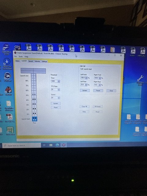

User calibration
Front: 60% → 100%
Rear: 80% → 10%
This is a radically different strategy:
Front becomes much more controlled.
Rear becomes almost completely released.
It is best described as:
Firm front, very soft rear.
The acceleration itself still transfers load rearward. The stiff front controls how quickly the nose moves, while the soft rear lets the suspension absorb the torque application and load the rear tires.
For the 100/10, it could be more effective on an unprepared surface or street-oriented tire when the problem is immediate wheelspin.

I have some stuff to add for just using on the street. Cleaned it up and went down to spend $70 for this mysterious liquid so it can run for a few miles. Since Sport comfort is more soft initially than Street, first I needed to feel it.
I agree, it sure is fancy and very subtle, but it is softer!
So, without changing their program we may have something there. If Sport (suspension only) has a more aggressive response to our inputs than street AND rides initially more comfy, I’m in.
Okay, I did a read to make sure I was looking at the right numbers. With the exception of this comfort setting I do not see differences btw the three different settings, in these tables. I am no genius but just looking at the G-force table and the braking table, the numbers look identical between the three?

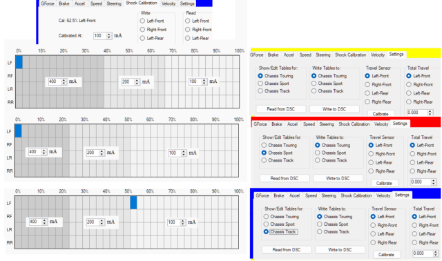

All of the GForce and braking tables are the same.
Where they differ is the Settings of Chassis Tour, Sport, and Track and how the % on the GForce table references the Shock Calibration Table.
While in the G Comfort "box" of <0.25 g the % in the Default rate is applied to the Shock Calibration Table.
For example,
Tour Default Rate of 34% outputs approximately 400 mA (soft).
Sport Default Rate of 18% outputs approximately 400 mA (soft).
Track Default Rate of 28% outputs 200 mA (firmer).
The acceleration table Launch start.
When launch is activated, the threshold timer of 1-2 seconds applies.
10% front / 20% rear is 400 mA front (soft) / 400 mA rear (soft).
100% front / 10 % rear is 100 mA front (stiff) and 400 mA rear (soft).
Outside of the "box" >0.25 g and acceleration launch, the G Table applies.
Using 0.6 g and 0 left/right results in 60% / 60% front, and 80% / 80% rear.
Applied to the Shock Table
Tour is 200 mA front (softer) / 100 mA rear (firm).
Sport/Track is 100 mA front (firm) / 100 mA rear (firm).
The best part is that you can customize individualized Acceleration Launch Tables for each Chassis setting.

The Tour, Sport and Track differences primarily come from the Shock Calibration table and G-Comfort settings and how quickly the suspension transitions from 400 mA (soft) to 100 mA (firm) vs gForce in each chassis setting.
This example demonstrates acceleration but in corning, each damper is independently operating on a similar, quicker transition as g Force increases.
Tour g = front / rear mA
<0.25 = 400 / 400 (GComfort)
0.25-0.4 = 200 / 200
0.40 g = 200 / 200
0.60 g = 200 / 100
0.80 g = 100 / 100
1.00 g = 100 / 100
Sport g = front / rear mA
0.40 = 200 / 100
0.60 = 100 / 100
0.80 = 100 / 100
1.00 = 100 / 100
Track g = front / rear mA
<0.25 g = 200 / 200 (GComfort)
0.40 = 200 / 100
0.60 = 100 / 100
0.80 = 100 / 100
1.00 = 100 / 100
The area that I'm tweaking today is the Acceleration Tables for Tour, Sport and Track Chassis. This table is predictive vs. GForce reactive and something I haven't really tweaked. The revisions focus on how the suspension behaves during the first 1–2 seconds of a driver input, before the dynamic control algorithms fully assume control.
Aside from the Launch suspension tweak, I'm focused on a road course suspension setup so we get more of the smooth, controlled cornering we felt from the gForce table (reactive) to the acceleration table (predictive). I always felt coming out of a low speed, low g Force corner that the hellcat was uncontrolled acceleration (perhaps a 400 mA to 100 mA transition) rather than a more controlled acceleration (200 mA to 100 mA).
The acceleration table (10%-80%) starts at 400 mA (predictive) so getting that started at 200 mA (predictive) for Sport/Track chassis setup. Next is tweaking the threshold, TPS and mph settings. We already have a good range of 1000-2000ms for threshold but a higher MPH might keep the suspension out of the 400 mA (predictive) on acceleration and in 200 mA (predictive).
