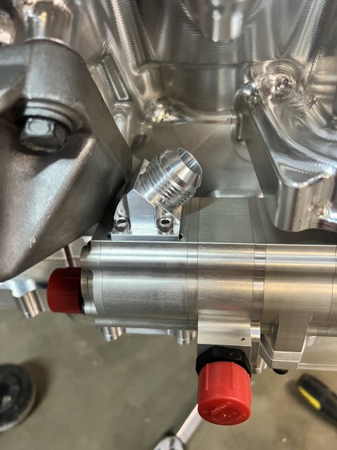

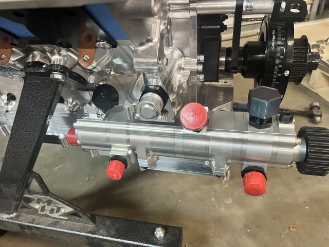

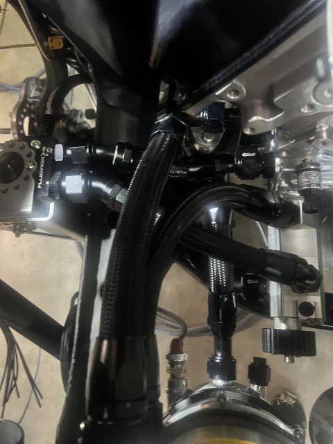

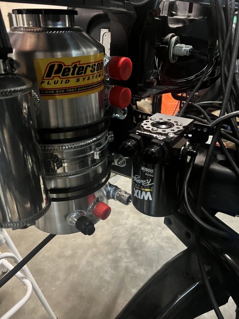

I’m running a Dailey’s dry sump on my Green Charger. It was intimating at first with all the plumbing I had to do and figure out where I wanted to put the dry sump tank and remote filter. It was a lot of work even with the pan, pump, and belt drive all figured out with the Dailey kit.

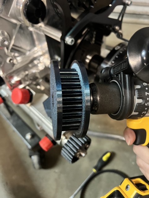

I’m glad I did it though because I got to learn and do some cool stuff along the way. Like I designed a special fitting to route around the motor mounts and also 3d printed a gear that I can attach to my drill so I can prime the system if need be.
