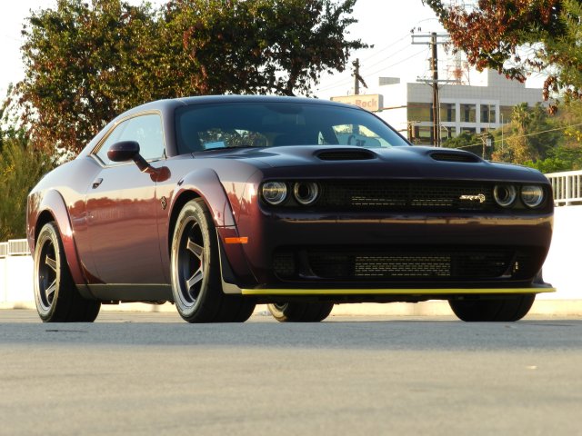

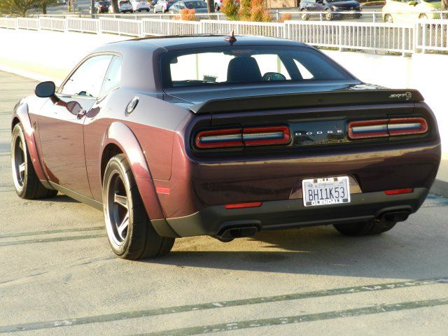

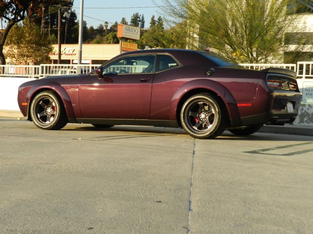

I was able to snap some pics with the Win Lites / Hoosiers on the car today. This is narrow body wheel on a wide body. I already had everything set up and paid for from my Frostbite car and decided to just run it. I think it kind of looks cool in the respect that now the front and back are sunk in a similar amount VS just the front being that way.......
. 0103210916_HDR.jpg 0103210916a_HDR.jpg 0103210917.jpg 0103210917_HDR.jpg 0103210918_HDR.jpg
