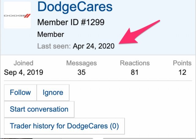

I could have put some much less expensive Phillips units on with larger tires on my ‘15, if they would have told us ( @DodgeCares ) they totally ripped the program out of the Demon and gave us something else and we now have a problematic farting and hesitating POS that shifts slower than my ‘12 Tahoe with a crappy 6 speed old style tranny.
@DodgeCares WHEN DO WE GET A REAL DEMON MOTOR IN THE HELLCAT LIKE WE WERE PROMISED IN YOUR LITERATURE? When are you really going to help us on this Forum? Let’s get this issue escalated to someone who can do something! Like NOW, BEFORE WE GET EMBARRASSED BY OTHER HELLCATS, FORDS AND CHEVROLET PRODUCTS. You have been called out previously on this thread and have conveniently ignored us. We are the people out there showing everyone how these work on the tracks and strips.
I FOR ONE WILL SELL THIS THING IN A MINUTE IN A YEAR OR TWO AND COULD BE INTO AN UPGRADED MODEL C8 IN A HEARTBEAT, AND NEVER LOOK BACK. SCREW SOME OF US AND WE GET REAL PISSED AND NEVER FORGET.
I dont think @DodgeCares ....cares, really shaking my head at this now...
