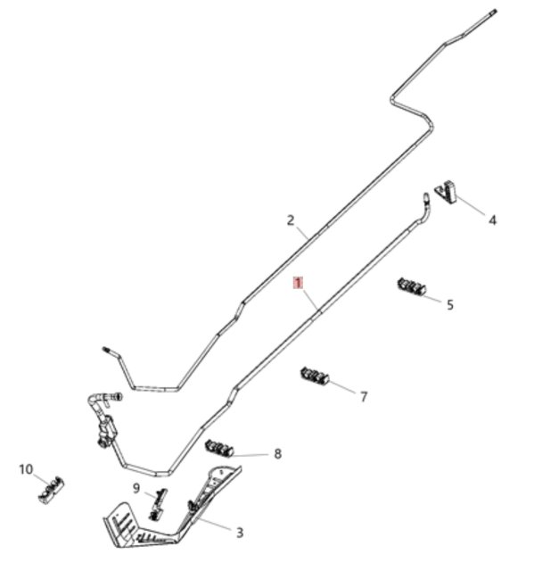

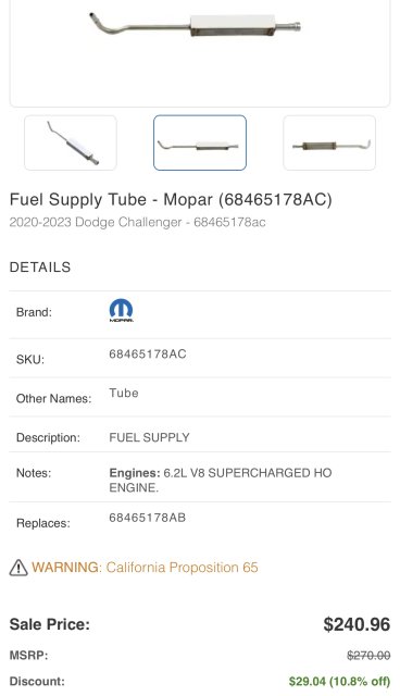

I've looked it over pretty good and other than a "voltage stabilizer" that's in the trunk by the FPDMs, the only other thing I see different is some kind of box the fuel line runs through on the passenger side. At first I thought it was a filter, but it doesn't appear to be serviceable. Someone suggested it's some kind of cooler? I'm also not sure this is unique to the 170, might be on other 2023 models.
Could definitely be a fuel cooler. Cooler fuel = more power. Wonder if anyone found out what it is yet. It also appears to be a thing on all 2023+. Just ordered the redeye/superstock/demon 18-22 main fuel line, and it’s not made for this, but that part says it fits regular hellcats as well 2023+

Expensive little bugger

I ordered this, which “should” not use that, but has the flexible fuel “jumper” to the rail built into the actual hardline
