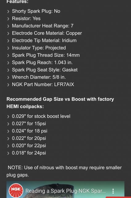

Hmm according to HHP by gap might be too big?

I use 2309’s gapped to .018”, I see very few miss fires recorded, none during WOT periods. Cylinder 8 seems to have the most, seems that way in allot of logs I’ve looked at not just mine.

This would be why you may want to pull the plugs and at least check the gap.
Taken from a post from 170 facebook page
"All plug removed had a gap between .033 1/2 - .036 with most between .034-.035."

Wider gap is for fuel economy but you will get spark blowout

Yeah, thinking I need to close up the gaps. I’m around 17 lbs of boost
