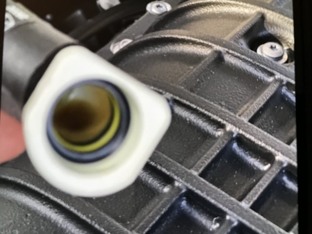

You’re right Speedy. 72 miles here. And small deposit already. I have not put my foot into it so no boost yet to speak of that would cause positive case blow by pressure yet. So I am thinking some of it might have gotten by from run in test at factory and rings not sealing 100% yet. Haven’t looked down it’s throttle body yet, but no doubt it’s going to be my first mod.
