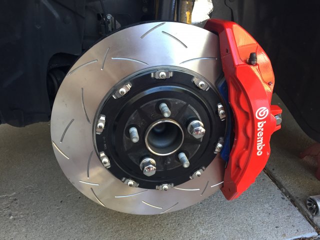

Good rotors IMO. Easily did the swap myself and re-used the OE hats... plus they’re nondirectional so you can’t screw up which side you put them on. Comes with new nuts.
