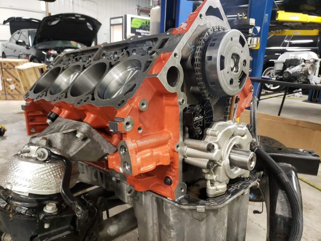

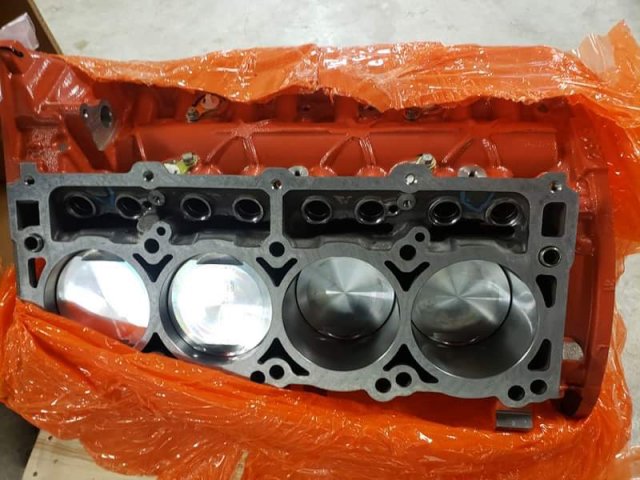

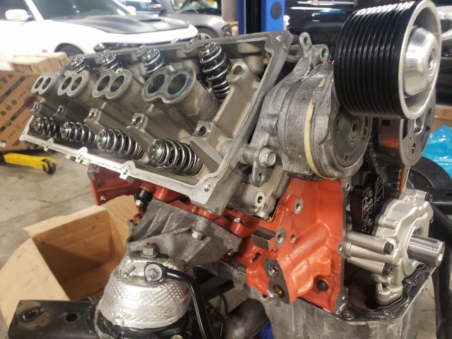

Motor arrived yesterday, but they forgot to ship a couple things that were needed with it so that will slow things down a couple days at least. They are working on getting the cam in today along with some other things. I’ll keep posting as progress continues A38D29ED-9DBF-47B5-BDA8-2D4297CD2D48.jpeg

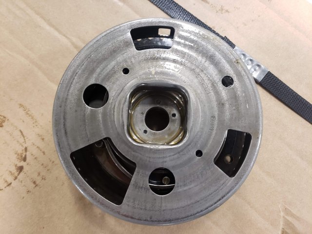

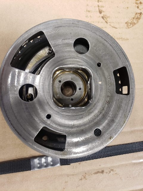

Update:
Broken cam phaser was found to be the culprit.
Something is broken / stuck inside of it.
Shop said they have never seen this before.
FB046EAF-D386-4025-8934-0058AC858E8F.jpeg D5EAA1A6-6B3B-4290-A553-9C389F3E1311.jpeg
fubar569
#1073
1,351
1,942
Bradford
#48
Thats... unique...
Damn son.
7,018
18,139
Wow. I didn't expect that one. Has to be a fluke. You're gonna have a bad ass bullet now though. 7,000 RPM shifts are money in these cars.

#50
Is that a snap ring out of place?
FFBOS
FFBOS
#1008
692
1,180
Mount Prospect
2016 Hellcat Charger
Thread Starter #51
not sure how a good one looks, but this one doesn’t move. Pin is jammed.

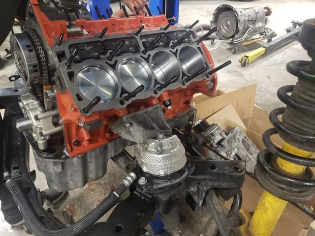

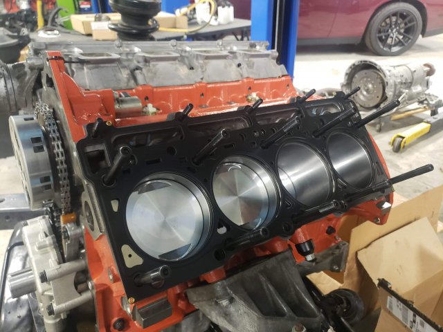

Might be up in the car today 8419A233-13EA-40B5-B9E2-4D076EA2E204.jpeg FBC7129C-29F6-4935-B36A-BCCE891EB5A7.jpeg DDD2CC4D-E28D-456B-B7EA-169202D9BB58.jpeg
