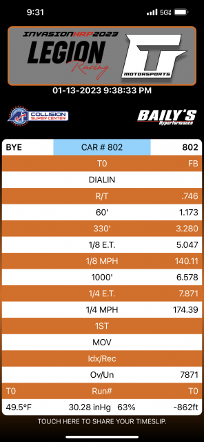

And here's a vid and slip of a 1.173 60', this was on a smaller 125 shot. Although I had less power, how you manage that power is also key. With some tweaks to the tune and how the nitrous ramps in, I was able to improve my 60' from earlier while going into a small power wheelie in the process. At this point it's a delicate balance, if I'm not careful and get over zealous, the car will absolutely stand up on it's back bumper.

1.1 60’?! That’s insane!! I have to get out of the 1.5s… thinking I have to swap out my 3.70 for a 3.09 soon and waiting for better weather. Putting in the work Z! That’s amazing

I see shocks helping this. Not doing this on factory stuff

That's a great looking run. Quick and fast cars generally aren't wasting motion/energy on wheelies. They hook and go. Like yours does
