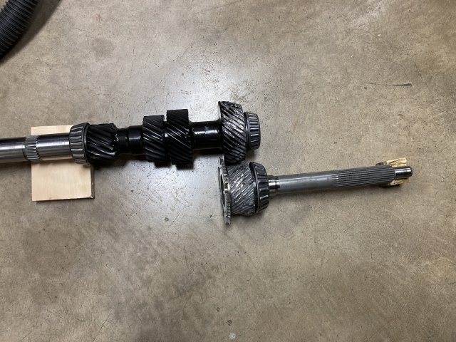

Doesn't Dodge sell the alignment tool?
I don’t mind pulling the trans again. Now that I’ve done it once, it should be a breeze the next time. Just takes a little bit of time but I’m in no hurry, can leave the car up in the air for as long as I want and just work on it when I want to and it fits my schedule.
It was worth it to pull it once and not spend the $1500 for a clutch just to see if cleaning the input shaft would work. If/when I pull it again, I think I might just replace the clutch with another OEM.
Not that I've seen anywhere. But these are the correct tool:
- MMX - pricey.
- Summit Racing (ignore the photo--it doesn't match what they send)
- Jegs
If it was in the clutch or flywheel surfaces, how would that explain the softer pedal feel (compared to the 2018 I drove?) Or are some years different! I thought the early years were supposed to be the stiffer ones.
I could never find one from Dodge the best is a input shaft from broken transmission give Rockland Stanard Gear George Mike they’ll probably sell you one cheap they have many of them laying around when this happens to the transmission which is often, The input shaft is useless and goes in the garbage except it makes a perfect clutch alignment tool of them a call if George isnt there ask for Mike he’s the guy in the shop that rebuilds these every day.
