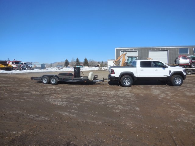

Actually Ram rated it for 10,800 lbs. No way would it survive a 1,000+ mile trip pulling my enclosed trailer. It was fine with the open trailer though.
Against better knowledge, curiosity got the better of me so I did try to tow with the new 1500.
It did better than the old one, but that's really not saying much. It was still very obvious that the trailer was back there. Yes, the drum was full, so there was a little bit of weight involved. Enough to sag the rear a couple of inches. DSCN4290[1].JPG

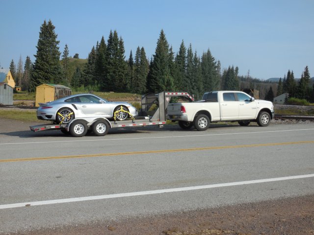

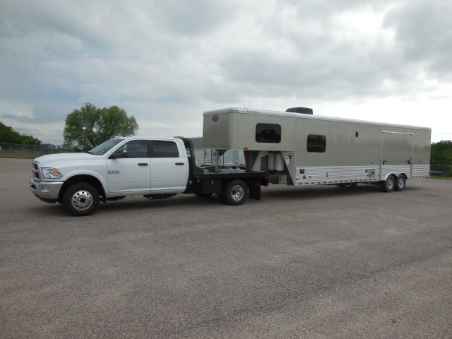

I've given up on bumper pulls, and 2500s.
These days, if I transport a car it's on or in one of these. DSCN2158.JPG DSCN3790.JPG
And yes, that first photo is indeed a 2500. But my girlfriend has since traded for a 3500 longbed.

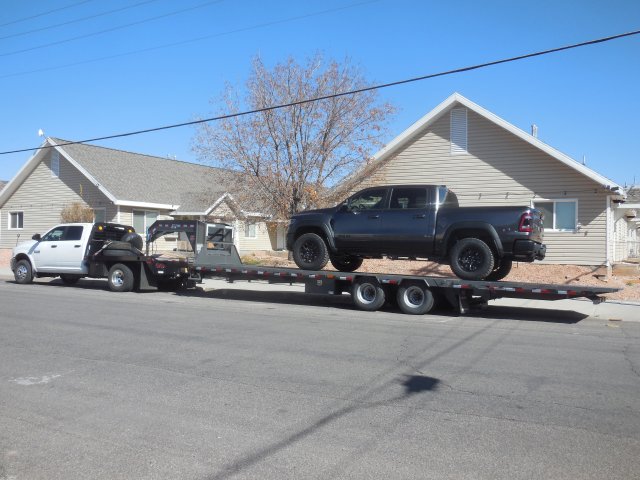

Top hinged side exit door? Sweet.
Thanks, and yes it is.
As and added bonus, after ordering that trailer four inches taller than stock, the 'Cat's door clears the inside fender, so I don't even have to remove it.

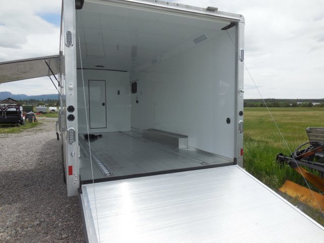

Have an shot from the rear with the ramp down?
Hang on, I'll post one in a bit. Gotta go dig a grave first.
6,679
12,438
#57

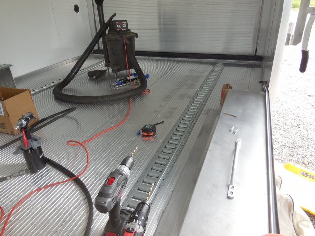

Here you go, Magnified.
This Sundowner lent itself really well to full length E-track as the floor is aluminum profiles.
I could put bolts through the cross members every 12 inches, then rivet all the other holes.
And as luck would have it, after making a decision on the width between them based on the track width of a few vehicles that could be transported in this trailer, it matched the factory tie-downs perfectly.
Looked at regular enclosed gooseneck trailers the other day, but damn...a little 24-footer cost about as much as I paid for this 38-foot living quarters version about three years ago.

When I was looking for mine, they had a 24' Sundowner and it's carrying capacity was less than the cat.
Very nice looking trailer.
6,679
12,438
#59
Thanks, David.
This one will accommodate a 'Cat, barely. I'm actively looking at air suspension setups for it, and in the process I'll go with 8K axles.
But it sure looks like I'll be making my own air suspension. Nothing out there that I've found so far is attractive to me.
#60
Thanks, David.
Mine is 12K less trailer weight so I'm good to go, plus it's 28'. A no brainer for me.
