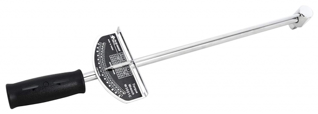

Took my 1/2 drive o-150 lb no name 20? yr old torque wrench in to check calibration today and it was 25 lbs low!!!
I bought a new one.
Yes, that is one thing I don't save money on.
20,157
I was pleased when my HF torque wrench matched my buddy's Snap On digital +- 1lb when we were doing the lugs on the Cats.
I don't always put it away with the spring unloaded, I use it frequently at 111ft lbs... but I've been told that is good practice.
Recommended calibration is every 5000 cycles or 12 months, whichever comes first. For context, that's only 250 tire changes. :cool:
