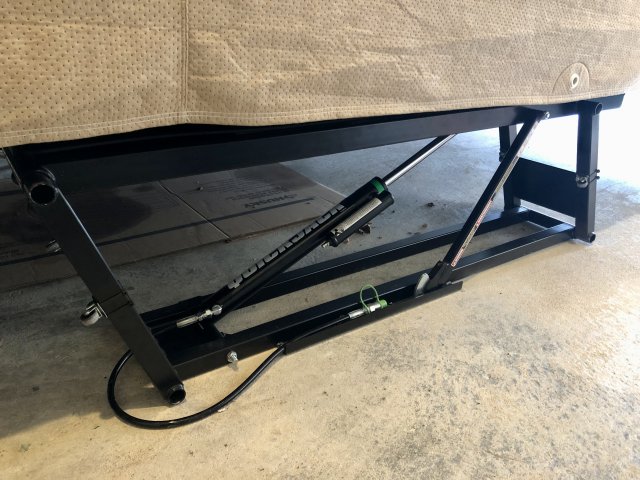

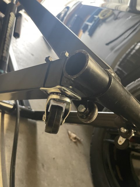

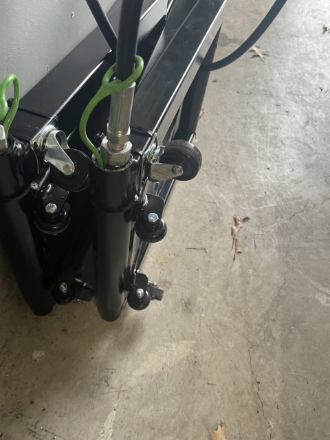

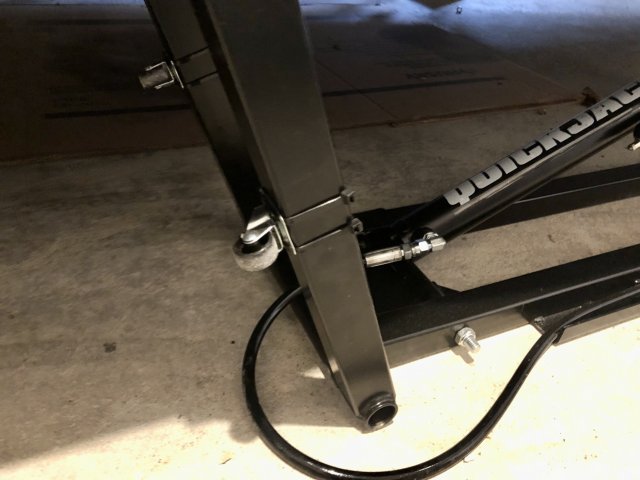

Pushing around the lifts on my 7k model gets old quick so a quick YT search revealed the following:
Simple mod that cost me maybe 15.00 in cheap casters. Casters are not the best but still swivel and roll good enough.

I like it!

Don't tell me you don't like lugging those bastards around by hand? :)
Mine had the same collar and pedicure.

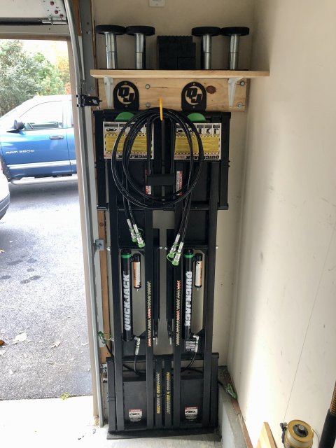

This is how I store them, which is a pita depending on how my back feels. 8B3BCF78-57BA-4545-A375-69AD2C0668D9.jpeg
6,781
43,105
This is how I store them, which is a pita depending on how my back feels. View attachment 60112
Yep, my problem also. Store them vertical to save room. Mine have little wheels on one side, so dragging them is a PIA but the little wheels make it a bit better. They are under the Cat until it gets driven now. I was amazed on how much more easy it was to maneuver them and plug the hoses together with the shoulder repaired!

On my brackets, I cut the "catch" lip down such that I don't have to lift them nearly as high to get them off.
Hope that helps.
Hope that helps.
Merry Christmas!
Excellent idea. I just took about 3/4” off mine. Thanks.

I just intentionally mounted my hooks about 1/2” too low, so the jacks support their own weight vertically and the hooks really just keep them from tipping forward. Just enough where I don’t have to lift them much when removing.

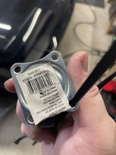

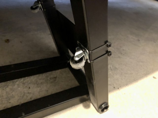

Just did this myself today so much easier to move!
2E48C4C8-0D42-418B-B5FC-D9B0291B151E.jpeg CF4958B1-D4BC-4259-938A-5AE927A8C38B.jpeg DCCD342F-5A0D-495B-8E8A-445D86B614C1.jpeg
11,710
19,832
I dont have these but looks like from your photo there are already wheels provided, they're just too small and rinky dink. Is that right?
