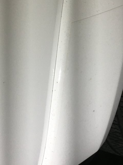

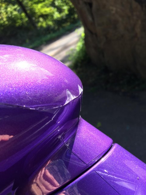

I had a bad PPF experience, so my advice is there is only one thing that matters, the specific person doing the install. Do they hand cut or use a computer with specific software to cut the pieces. Stay away from the people who hand cut.
Any chance your shop installed past the hood vents, or did they stop short. Curious how it came out if they went past the hood vents, if you they did, could you post a pic?
Agree...stay away from the free handers. I'm sure some are better than others but I'd rather have a plotter cut my film OFF the car than someone free-handing it on it.
My shop did cut past the hood vents and wrapped as best they could but because of the movement of the plastic vents and the expansion with heat transfer it will eventually push up the edges of the film in a few spots. They had to tweak mine to have it closer to the edge of the vent with it far enough away so when the plastic expands it won't pull it up. Top and bottom left of both vents were the worst areas (see pics). After trimming those areas back...much better.

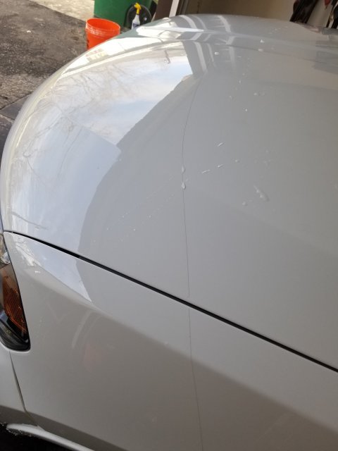

Question: If the installer brings the film a partial way up hood/around fenders/up from rockers/etc., up close to the vehicle will you see an obvious line where the film ends? My guess is yes?

Yes you will see the line. Would be best to do full hood, fenders and flares.

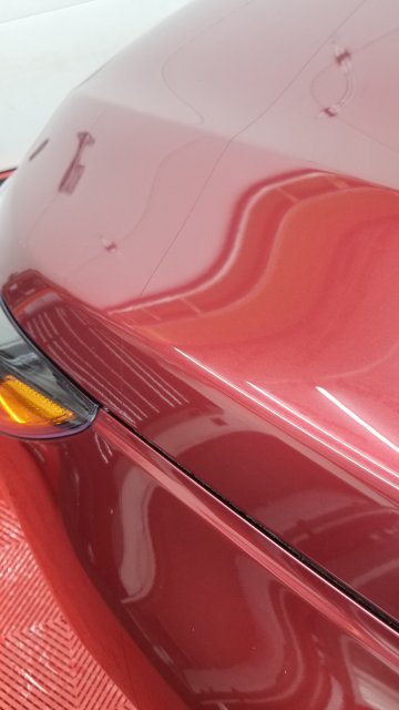

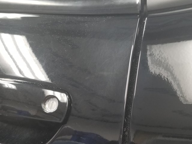

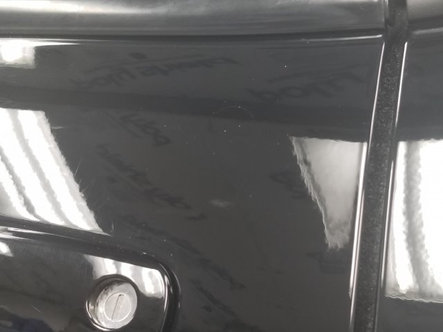

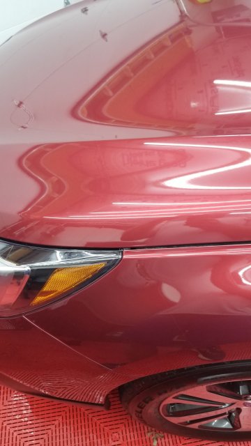

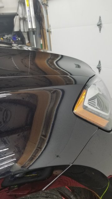

I install both PPF and ceramics. I have 2 plotters for different sized films so I can do full fenders and hoods. I have TRIED, I menan TRIED to do both my Jeep SRT and Hellcat hood in full piece. (I used a full role of film, 50 feet or $1100!) I've full hooded Mazda's and Subaru's with no problem. The deep recessions around the vents or intake is an absolute nightmare. I have just started doing filming this year, I've done about 30 vehicles, many with plot cuts, many with hand cutting. my vents around the charger are similar to what has been show, the edges start to lift, there isn't much area to grab, the film is stretched trying to hold on. The key to hand cutting is the cuts need to be over voids and not on the paint. So the edges of the hood or fenders, you can freehand those with scissors running up the edge to allow you wrap the edges. I have full fenders on my Jeep and Charger and a bikini on the hoods. Bumpers get tricky if you want plot cuts, the Jeep is 4 pieces, the Charger is 3, so you end up with seams. Someone who bulks may be able to get it in one piece.
If you run a bikini line or fender tip, you will have a line, it's only noticeable in certain light on certain angles. The light needs to be reflected through the edge so it can be seen.
As for ceramic, anything over 2k is you being taken. Unless you have a showroom car that is never driven don't pay for 95-99% correction. It just won't matter. Sure it will look awesome at the shop, you take it home and put 5k miles on it, you're money is gone because your paint will pick up defects. You can pickup 70 or 80 or even 90% with a good one step polish and pad combination. Sure you can further refine it with a second step for more gloss. The average person isn't going to notice a difference the higher % you go. I do a full decontamination followed up by a one step polish then lay down a professional coating for $750 on a standard sized car. It's good for 4 or so years, even if you get 3 and re-do it, you'd be at $1500 to 2 surface reconditions and coatings compared to some of these outrageous shops. I know of one place that charges $1000 to ceramic coat PPF. No prep is needed on the film, $80 in product and 2 hours of your time, these guys are ripoffs.
I attached a few pictures, the paint was one stepped in the picture of the door pull. The others show bikini lines.

Great post! Just like any industry, a certain person will try to upsell you on more, even if unnecessary, and why it's up to the consumer to do their research. One of my all time favorite quotes is from a 1980s Syms commerical, an educated consumer is our best consumer.
At least I can take away lesson, no more PPF for me and ceramic coating is awesome...and I should have drove 3 hours away to my audio guy who also does detailing, he is one of the few hard honest working people out there that will not screw you over, and stands by his work.
