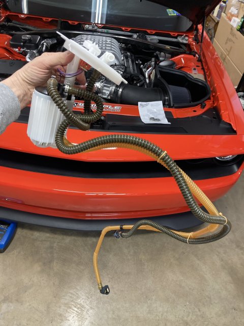

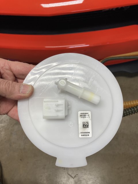

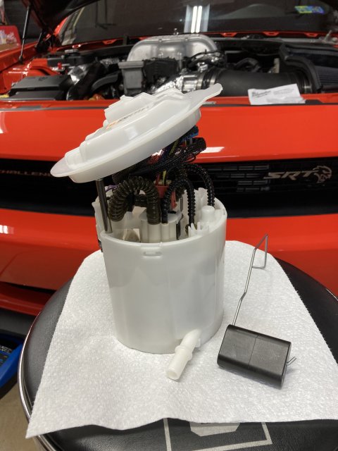

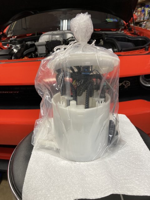

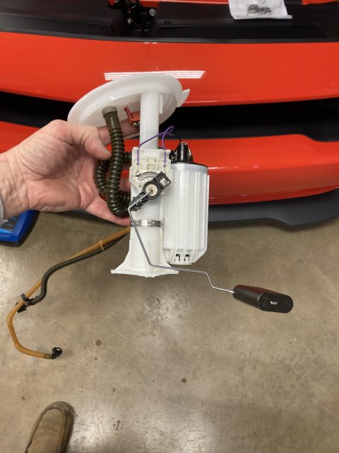

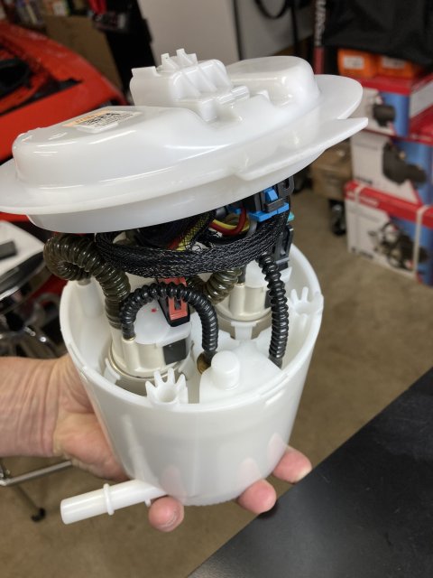

The mechanic is insisting that my secondary fuel pump is on the drivers side. I have a puncture in the fuel tank on that side and he’s insisting that it broke the secondary fuel pump. He told me the aftermarket primary pump that I bought is the wrong part. I’ve searched numerous forums and looked up the factory documents. I drained the tank myself trying to fix the leak prior to and I’m pretty sure I saw the pump on the drivers side too.
I didn’t bother to argue though. He’ll see when he opens up the tank on Monday.
3,810
9,026

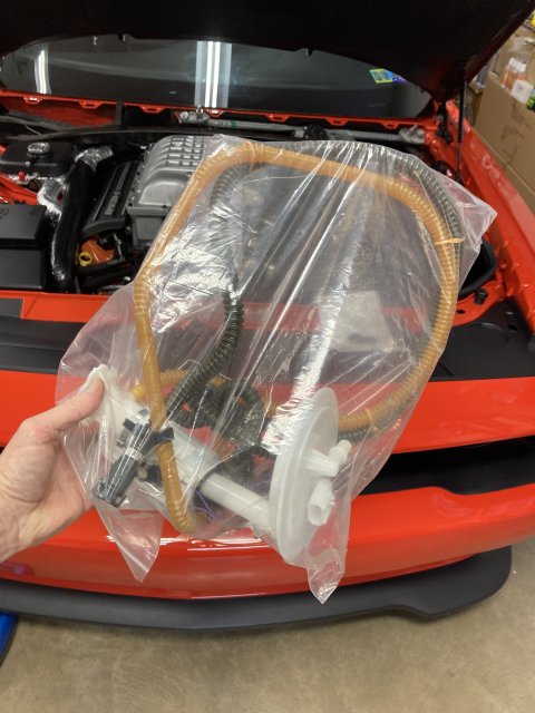

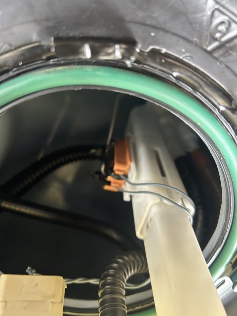

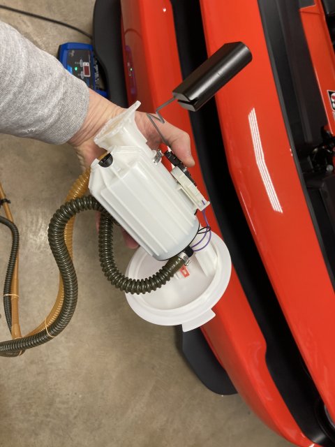

There is no pump on the passenger side, only a fuel level sensor and a device that looks like a pump but has no wires going to it, ie it’s not a pump! Fuel is pulled from that side by a Venturi effect from the primary pump (or pumps if a Redeye). If it were me I would be highly questioning my mechanic on this. Picture of everything that’s in the fuel tank under both bungs.
IMG_4053.jpeg IMG_4054.jpeg IMG_4056.jpeg IMG_4057.jpeg IMG_4058.jpeg IMG_4059.jpeg IMG_4060.jpeg IMG_4061.jpeg
