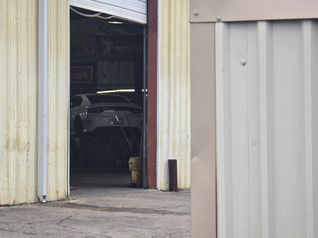

Scheduled for this Friday...but supposed to rain so might reschedule.

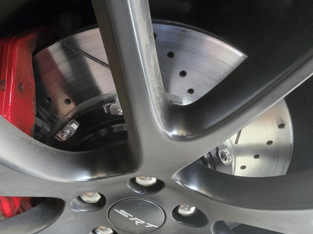

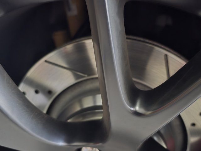

Got all new rotors and brakes installed this morning. Followed PowerStops brake in instructions (felt like Radford again).
Front:
20241101_111850.jpg Brake dust residue (hopefully good sign I did it correctly).
Rear
20241101_111909.jpg So far so good. Happy...but can tell difference between Brembos. Not a bad tradeoff for no brake dust.

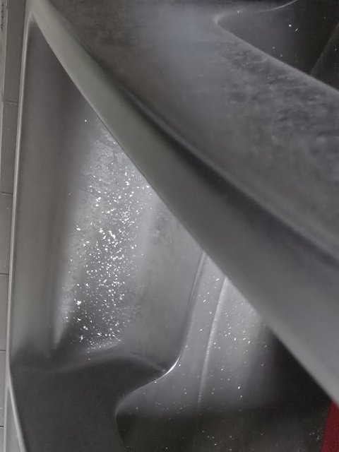

Now that I have broke rotors/brakes in...can I wash the wheels to get brake dust off or should I wait to drive more before washing in case I wash off anything meant to further break in?
Next project is PS4s.
9,687
56,946
Those PS should have nearly no dust. My chrome wheels confirm that. They must have initially busted off some of the rotor debris, you should be good to go.

Heavy bedding, even with "low dust" pads will do that, if you feel like they have the bite that they should, and you're not going to do a second bedding, clean them up. Although if you're going to do tires shortly, wait until that's done, because the wheels will have lub all over them after that and need cleaning again.
