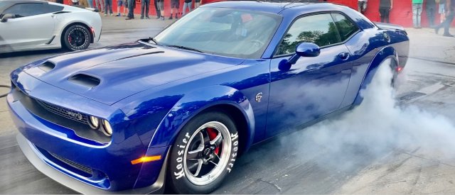

Wanted to see how the car reacts to the heat, so I made a couple passes last night. On the first pass, I was racing a friend of mine in his modded C7 Z06. He normally runs 6.50ish so this was going to be an exciting and close race... We got to the line and I brought my rpms up before fully staging, the car kinda went in and out of that weird thing where it sounds like it's cutting cylinders (almost like you're using launch control). I raised it some more and thought it was ok, the light tree came down and I hammered it on the last yellow... crickets... nothing happened! The car sat there and didn't react and my foot was to the floor... it seemed like an eternity but it finally got throttle and took off. The Z06 was long gone. Never had that happen before, has anyone else? I'm sure it was only several tenths of a second but seemed like forever that the car just sat there.
Decided to make a 2nd pass so I didn't go home disappointed and confused. Everything went well on that pass except that it was slow due to DA and the car was hot. Went 1.46 60' and 6.70 at 104.x. DA was around 2700'. Really thinking about doing E85, tune, and injectors as I don't want to be running 6.70s (or worse) all summer.
I'll review datalogs and videos later. At least I got a cool picture for now:
