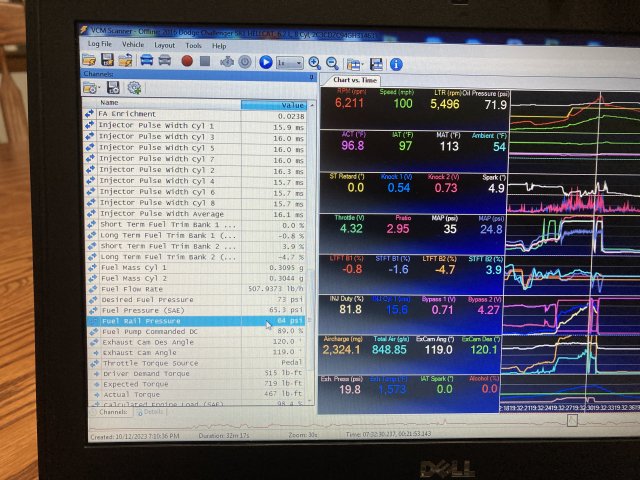

I need just a bit more fuel, fuel pressure dips just at the top of third and fourth (M6) driving injector DC up to just below bypass valve openning, hitting 81%, bypass will start openning at 85. This a Temporary bandaid until I add a third pump over winter as I’m not a BAP fan as a permanent solution.

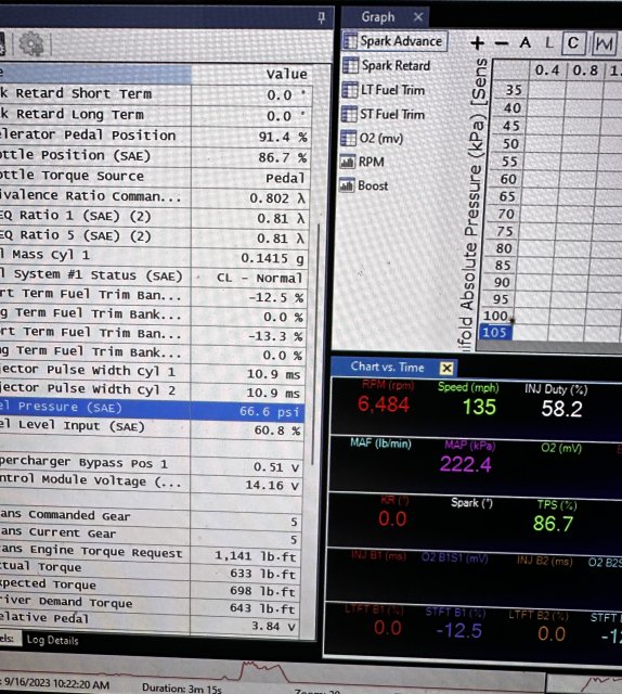

Mine dips to 64 I don’t think that’s a big deal, mostly 70-72 through the pull. Then again I have the redeye fuel rails but I don’t think that changes anything

Exactly. Look at Unholy’s injector on time, 10.9 ms, I’m at 16 ms when my fuel pressure is waining down to 64 psi. I’ve got no time left!!! Now I’m on yet a different fuel pressure sending unit that whipple supplied but I’m looking more at injector on time atm then read fuel pressure accuracy, the injector on time is telling my I’m going low on fuel pressure, too low now.
