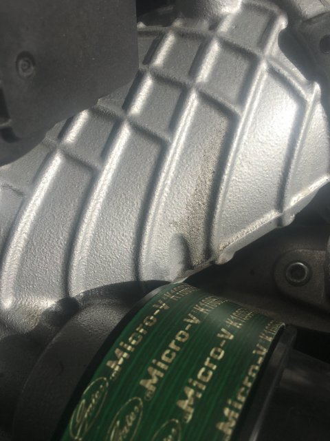

Confirmed. Ding, ding. Speedy that looks like the beginning of the end for that pulley. We are standing around between sessions and being gear heads I found a previous photo of my pulley. I think my “dealer” will take care of it next week. My belt looks like shit, I am going to have that looked at too. The Red Eye has about 5000 miles. I am standing in front of the my old ‘15 that factory weirdo (dyno’ed at 670 and can support the bad ass reading) has one of the black ones that looks brand new at 23k miles. I just drove the sweet old thing around the track for a session in the wet to begin with! We bonded quickly again😉😉 Then it dried out a bit and we flipped to Track Mode. WOW what a difference that mode makes when lapping!

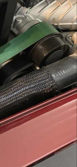

Belt looks normal. Green turns to shit. Not only did the grease cap fall off, which was the small circle cap, the whole front of the pulley fell off. Car probably isn’t making boost now. The internals failed. Just make sure it doesn’t drive itself into the snout.

Thanks, for more info, your right mostly no boost, drove it a few miles today to get it loaded up. It is on the trailer doing well. I'll take it to some friendly gentlemen. Looks like a bad one, my engine/computers are all untouched. That green belt has looked like that forever, character I guess.
The screws were working well to the end. After it cooled down the internals of that pulley must have finally bit it and won't engage.

Not many of the stock factory ones. There have been handfuls of the smaller sized litens that have failed in the exact same way.
