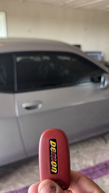

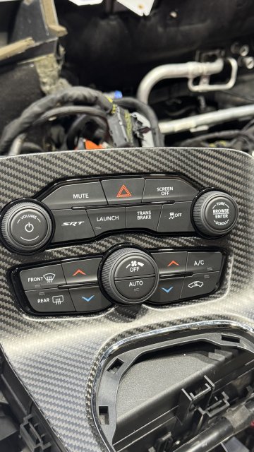

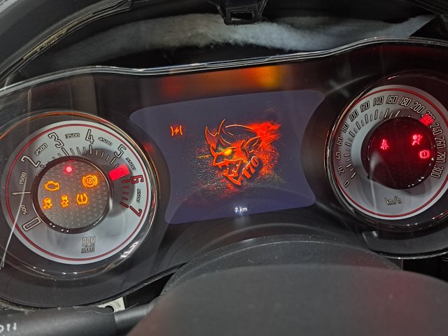

It's been a bit since I updated this. The rest of the harnesses finally came in and we got the car wired up. Some work with witech, and CDA6 got all the new modules programmed to the D170 PCM and VIN. Everything seems to be working correctly EXCEPT that I need a uconnect radio from a 2023 car. The D170 actually has a unique radio part number, the one I have is from a 2019 so it seems to be pulling 2018 Demon info and doesn't have the trans brake option on the screen. Getting a 170 specific radio probably won't be easy so I'm hoping a 2023 radio will pull the info from the BCM, or that it would somehow be able to get programmed with D170 software. Initially, I figured all the Uconnect 4 radios were the same but there are multiple part numbers that span different years. The door harnesses and door modules changed somewhere along the way so I am working on getting those for a 2023 car while I wait for the PCM to come back from HPTuners.
A few options on the drag screen show as unavailable to change but that is doe to there not being an adaptive damping module plugged in, that has finally arrived as well.
Another interesting fact is the Demon 170 uses a factory boost a pump deal which appears to be a voltage stabilizer part #56029583AC used in Cherokees and Compases. That will be here in the next couple days to confirm as well.
1637898466641436887.JPG 2062407097369962999.JPG 3228951145089045801.JPG IMG_9154.jpeg

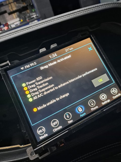

Found the issue. The Demon 170s have a unique radio file flashed to the radio. It seems that the 2018 Demons might be the same as I've seen some threads of people that had their radios replaced due to delamination issues and they had the same problems after.
Whereas a 170 Should have Drag, Custom, and Auto modes, I have Track, Sport, Custom, and Auto. It's essentially working as it would in a Redeye.
If I hit track it brings up the screen saying Drag mode activated and checks off the list of drag features. Also when you put the suspension, steering or trans in track on the toggle, on the lets call it overview page it shows them in drag mode. It also keeps me from having the transbrake 2.0 features. I'm going to somehow see if I can track down the radio file, if not I'll have to try and find a 170 Uconnect radio, which I've heard are exchange only probably to keep people from doing exactly what I'm doing.
