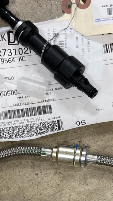

I think you maybe putting it on wrong? It doesn’t go through the holes s as bd out the other side it goes around them then some have white plastic cap to insure clip can not come out. I’ll see if I can find a picture.
3,588
8,446

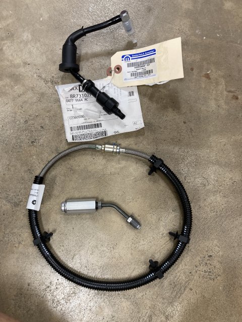

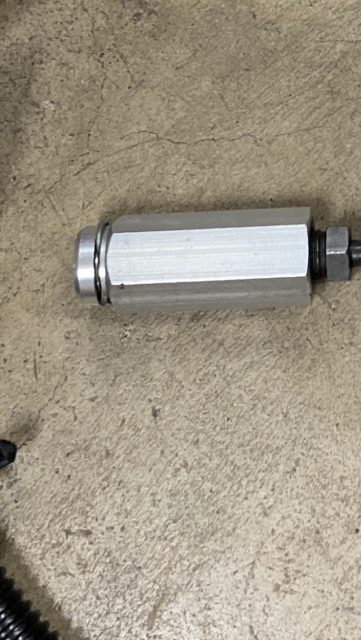

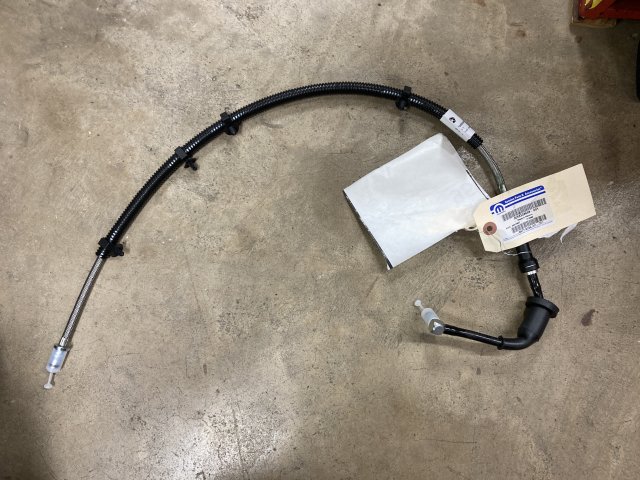

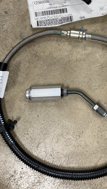

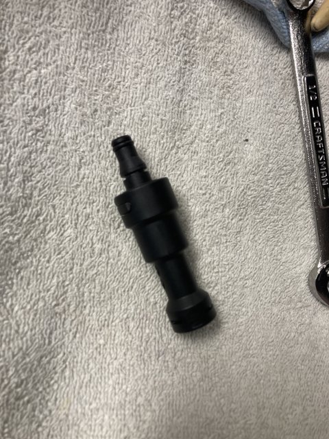

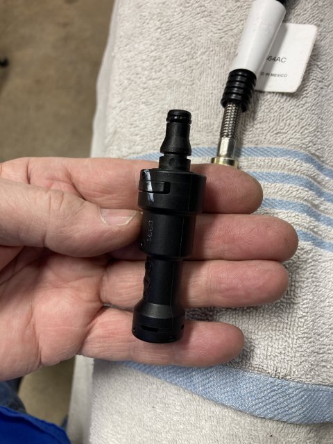

Here ya go, and BTW, the little blue X device is not the clutch delay valve. It is a restrictor to limit speed both in and out, the black device controls flow as well but allows full flow forward and restricts on the return, it’s called a flow check valve. It’s located under the brake booster where the clutch line comes through the firewall.
IMG_8994.png IMG_9541.png IMG_9476.jpeg IMG_9474.jpeg IMG_9540.png IMG_2478.jpeg
The guts can be removed from the black item, and put back in as well. I have Draggy data that shows faster shifts with it gutted. I’ll post if I get time to look for them. I’ve posted this all before if anyone what’s to search my posts to find it, has draggy data and all.

HA ! THATS IT ! I was trying to pu it INSIDE the grove...not around the outside . THANK YOU !

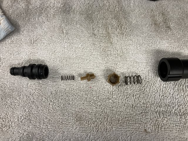

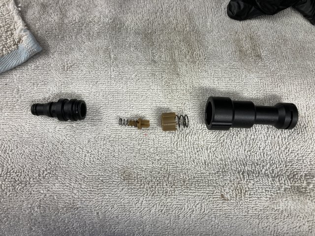

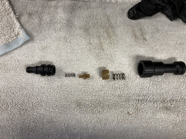

Here’s the guts from inside the black item which is the true Clutch Delay Valve. It’s very easy to take apart and clutch action difference is noticeable when gutted.
