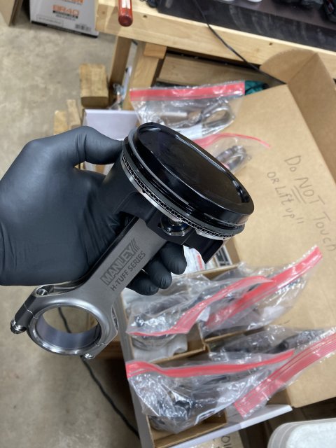

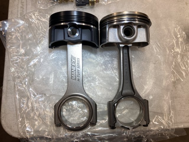

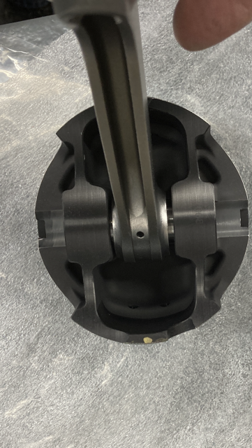

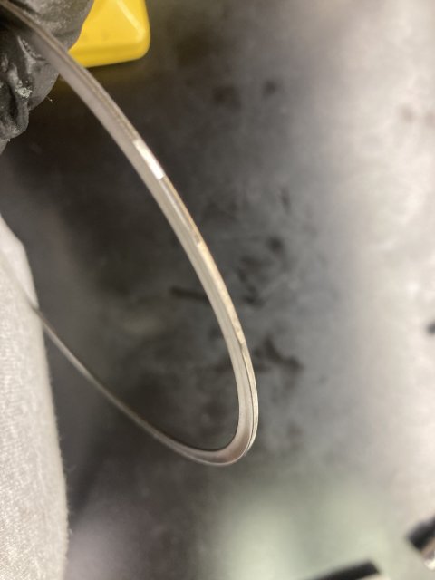

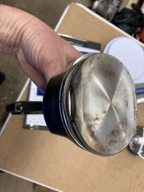

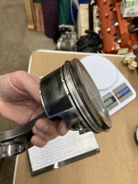

My number 7, typical failure, piston popped at thinnest point under a valve relief. A few theories, one is the corner cylinders run the leanest causing them to run hottest which leads to ring butting of the tightly gapped stock upper ring and pops the weakest part of the piston out exposing the ring to even more direct heat, the rings start to delaminate and leak more causing even more heat and expansion until the piston locks up at TDC on turnaround of the exhaust stroke and the bottom of the piston gets torn off and makes its last trip down the bore and out the bottom as on the next up stroke snaps the rod in half and makes a window to the world with the wrist pin like a shot gun slug.
440C3425-B2F8-498C-8C9E-6FE7FF43C429.jpeg 5008A8D7-1D9F-41A2-B7D1-8827CCED21AC.jpeg DD02C2B0-FF60-4C7F-8EF9-AABB0CEABF78.jpeg
Replaced with these, .330” of meat between the fire storm and the ring, hard anodized top and ring lands and pin bores, PTFE coated bottoms and skirts. .250 wall H13 DLC pins with very close pin boss spacing on the piston keep crown flex to a minimum. Connected by a 4340 Manley H-Tuff rod on King Coated bearings. Top ring gap .026” verse stock .014-.018” which I think is the killer of these engines. Probably why a colder 180 Tstat helps and hot IAT’s and ambient temps doesn’t. Hoping this lasts a bit longer, someday see a bit of spray too possibly.

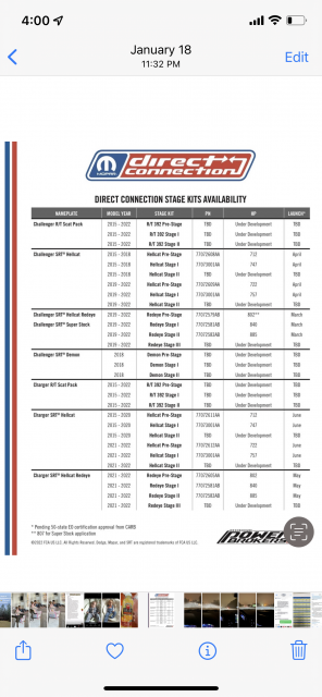

The Direct Connection parts kind of align with this as well. You'll notice there is no stage 2 for the Hellcat like there is a RE.
View attachment 63612 View attachment 63613 View attachment 63614
View attachment 63615 View attachment 63616 View attachment 63617

The stage 1 on the hellcat is the same. Pulley and tune on redeye and hellcats. The hellcat 94C1D31B-04B2-4D34-BBEC-AF0D4AA0FB4C.png wont get the high octane option probably because it runs a single fuel pump and smaller injectors compared to the redeye dual fuel pumps and demon injectors. But stage 2 is in development
7,671
20,086
#71
It's not the same though. Hellcat has a 2.4L supercharger RE is a 2.7L so the same pulley will make a lot more power on the 2.7L.
The point is the Hellcat looks to only get a measly 40HP bump. RE gets quite a bit more and "stage III" in development. They're worried about something on the Hellcat motor and I be it's the rods.
