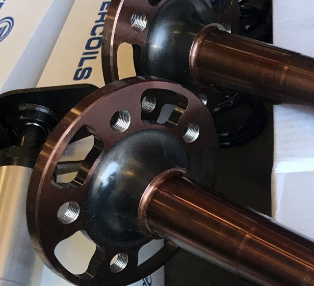

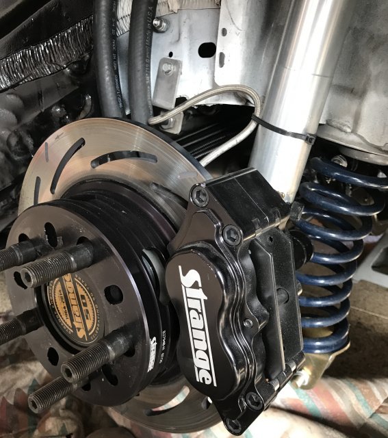

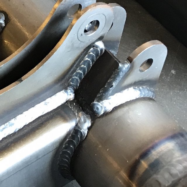

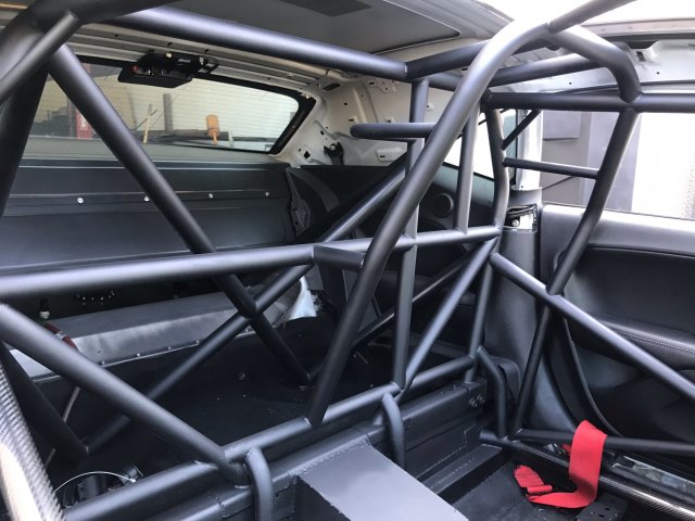

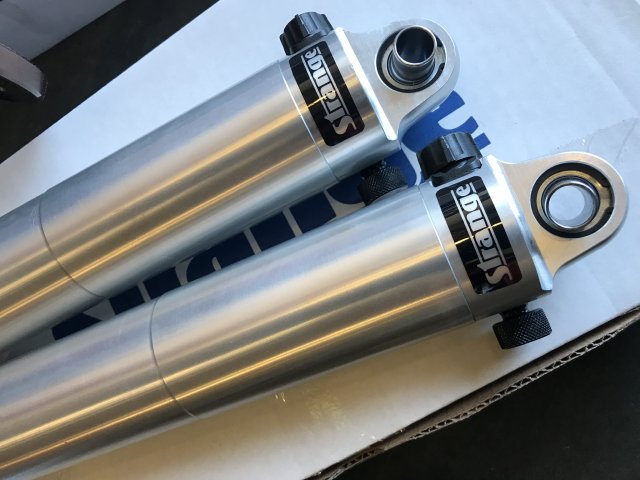

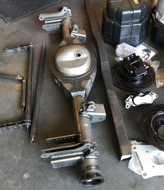

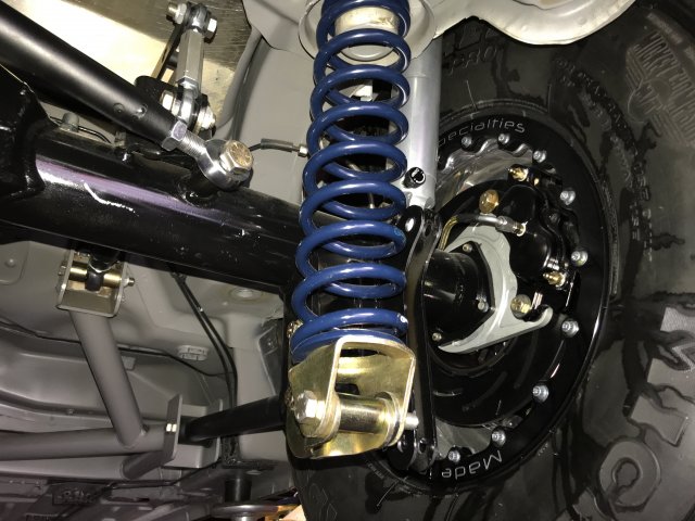

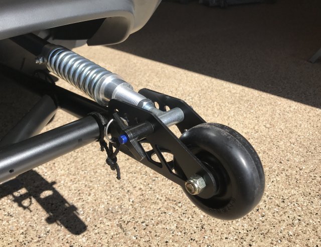

MPR in Almont, MI. Mike Pustenly (MPR) was a part of the original DragPak design group and he sells the 2015 version as a complete ready to install package. It’s all Strange engineering stuff. Including the fabricated housing with brackets, aluminum bolt thru carrier with Pro gears and spool or Wavetrac. 40 spline gun drilled axles, brakes with billet calipers, Strange adjustable shocks and Hypercoil springs. Also includes the crossmember that becomes a required part of the roll cage and ties everything together. Wheelie bars and the matching front suspension and brakes are also available. You would have to call and get a current parts list with prices as I’m sure it’s all gone up since I did it. I have a total of about $10k in the parts package for mine. That includes the front suspension (coil overs) and brakes plus the manual brake and steering conversions. B61CBA4F-EF4A-41A2-A57F-A0EB42D61DDC.jpeg 8D4FAC54-1766-4B8B-A060-9AEBC09F9B7A.jpeg F47613AA-19B4-4C0A-9C8D-F03AAD3657FE.jpeg FC2CDE28-137C-4ED8-A52C-6214B343B29C.jpeg 8C866AC4-1D4A-4C53-BBB1-774A32190849.jpeg 16719208-A01A-4099-A8D0-FB6F0B2DDA96.jpeg CE823F5D-BE3E-43CE-8166-1948F3F15CD0.jpeg

It is extreme from the install end of it. It requires a full cage that incorporates that crossmember and bars that tie in the 4-link link mounting points. Plus modifying the driveshaft tunnel and undercarriage over the rear end and replacing the fuel tank with a cell. Whole new fuel system and on and on. Once in, it’s fine for the street from a normal driving standpoint. The only thing that sucks is the manual steering. It’s still a heavy car and that Flaming River steering is like wrestling a bear. I would never suggest this is for anything other than the goal of a seven second car. For anybody wanting this….. you need to be able to do much of it yourself or have some connections and work some deals because if you have to pay the going $150 per hour rate… you might as well buy a DragPak. Picture of the other side of that….. 2BA21F55-80F9-4291-ADD1-DF179D882EDC.jpeg
