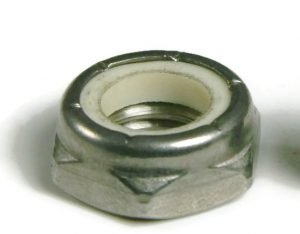

Could you turn those bolts around?
Or use all thread with nylocks on both sides?
Or, is the housing threaded?

It is a bolt/nut. I am going to watch them today. No lock-tight so I did not add that, they seemed light a light nylock type. The fronts are a good nylock type. Today, I'll take some more peeks at them because one in the rear was loose after just a little street driving. Same arm as the arm getting smashed by the sway bar. I am not far from adding some blue lock tight.

Would a low collar nylock help you with this since they aren't as tall? You could also then trim the bolt if necessary.

I’ll need to look at what they have.

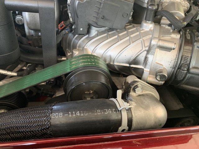

Okay you supercharger spinning nuts tell me about this piece of shit. Is this the first time someone took it out a Demon/Redeye brand for 15-20 minutes instead for 15 seconds, and ran a lot of 4-6k work on it? After a good session, we were inspecting and found the grease that sprayed around. That pissed me off because I keep it clean. After that - no supercharger. The scream is gone. Oh, did I say I was pissed at my flipping Mopar tonight?

Are you saying SC Failure??
I have ran the dog shit out of mine on back road runs(in Mexico) at the 4-6.5 K range and no issues.
Sometimes 20 minute runs.
I did have a weird oil/grease spray like that when I picked up my car "new".

Difference it it won’t spin. What’s fun is we have video, and tons of data if they want to compare my notes. Seems the bearing went to shit and won’t spin it now. SOB went out I glory. I noticed it did not spin for a half mile or two before coming back to life for about 15-20 minutes. Then after some rest, no SC spin.
