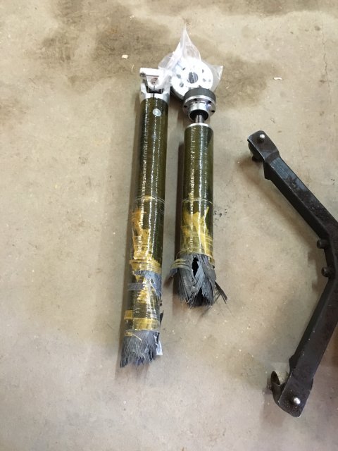

Thread Starter #271
My ‘15 Hellcat did a big 4” unit up before I got my foot to the floor.
That car still uses the prototype 2.5” diameter QA1 fiberglass driveshaft, and the owner loves it.
Enough said.

Thread Starter #275
Fuckin starting line, it either hooked and busted when something flexed, or it hopped once. Felt like it grabbed so I nailed it and it busted before my foot hit the floor. Wow, these things are torque monsters. So I will just apply the power a bit slower on the road courses.[bash]
They send you a new one? Can't believe it snapped like that

Thread Starter #277
Nope, did not desire another one either.
