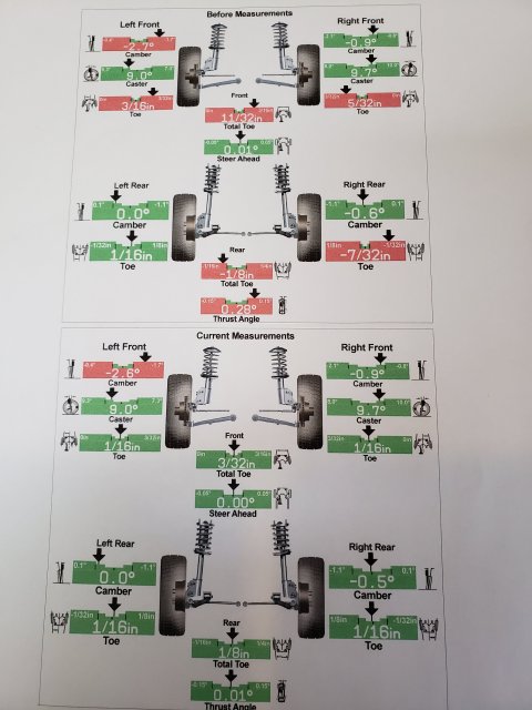

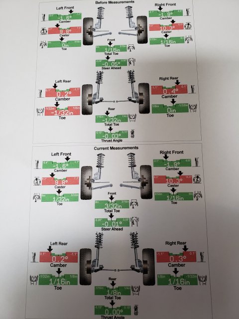

Had the alignment checked today. When I did it the 1st time I had +4 tabs in all the arms. After talking to Parker he said I needed +5 driver side and +7 passenger side. Gas was just over 1/2 tank like last time
@Speedy! you should go in and check yours again. I think your right front camber was -2.4 My left front camber was -2.6 I didn't change anything on the front and it was -1.6 and the right went from -.09 to -1.9 so no idea what is happening up front.
Also speedy there was a fan on and the left rear camber was moving some from +.10 to +.20
The top sheet is last time before and after and bottom sheet is today. Think it is pretty close
Like @DGatzby said the toe will move when you change the camber and it did

That looks pretty dang good to me.
View attachment 74035 View attachment 74036
I like it. That car should hook and drive straight.
Tell your friend he did great!

It felt amazing last time out. I had the +4 and +6 in it then. Should be +.2 more per side now
I didn't like the fact I changed tires and arms at the same time but after the bad wheel hop I wanted to do everything I could to get rid of that and I did
This looks pretty good TBH. I'm a lot closer to zero than this and mine does pretty good. I think my call of 4's & 6's would've set you dead on 0/0 side to side. A setting to remember if you ever need it for some other circumstance.
Reminds me to check and order tabs for mine. I'm gonna tweak it slightly whenever I get bored.
I should have been real close to 0 last time out being I had 4 and 6 in. Think Parker was aiming for +.25 and that is about where it landed
