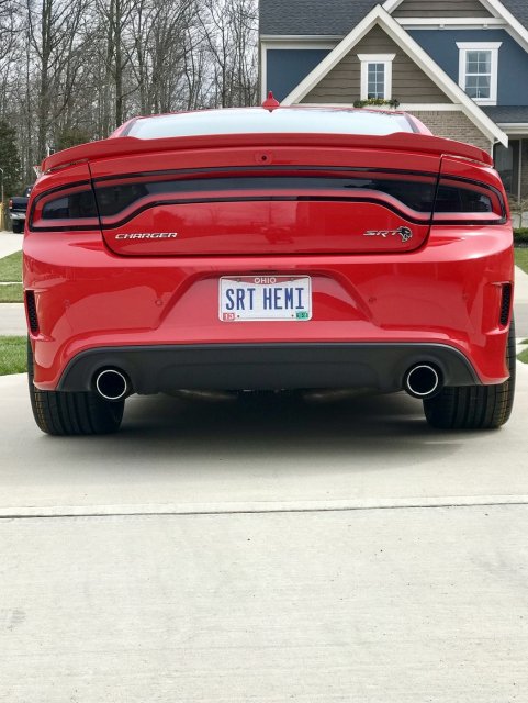

What are your thoughts?

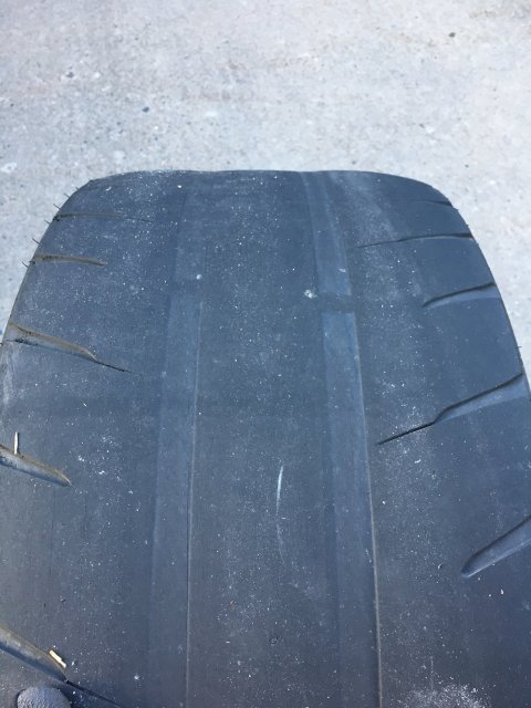

My thoughts? Your putting a tire in excess of 12" wide on a 10" wheel and wasting nearly 2" of rubber.
Here, I'll pull out the picture of a 315 on a 10" wheel that is well done. You decide if the extra money for those 1" rubber on each side ever worked. IMG_0585.JPG
Here, I'll pull out the picture of a 315 on a 10" wheel that is well done. You decide if the extra money for those 1" rubber on each side ever worked. View attachment 12547
If you air down enough the rubber will not be wasted. Remember if your drag racing your airing down pretty low. A 315 on 17x10 would be OK. Some guys are running 315s on 17x9.5
That looks like the rear tire on my old VMax years ago. Beautiful tread around the very lip but a baloney skin in the middle :D
