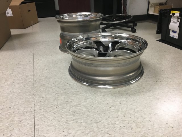

Do the rear wheels have knurled beads? Are you worried about the tires turning on the wheel?
HRJ
HRJ
#1045
478
1,043
Porsche GT3
Thread Starter #69
No knurles. Yeah, they’ll spin on the wheel but they don’t weigh near as much as a beadlock. I can have the tires moved back pretty easy here at work.

What is the rear BS and offset for the WB?
HRJ
HRJ
#1045
478
1,043
Porsche GT3
Thread Starter #72

Random question, I’m looking to order those rear wheels. But when I’m on the weld website I’m seeing 17x11 6.2 vs 5.8, I’m trying to figure out what that is. Which option did you run? I’m looking for that exact look in the rear that you have!
9,066
23,951
#75
Welcome to the site.
Lots of very knowledgeable people here.
An old post, but someone should have your answer.
#20108
15
9
Space Coast
23 Demon
#76
5.8 was the backspace used on the OP’s car.
