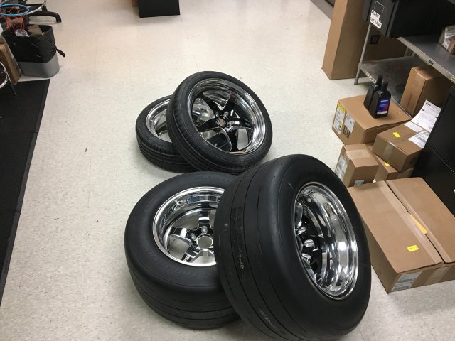

Got the TPMS sensors and tires installed. Front tires fit great, no issues there at all. They also balanced very well.
The backs I had a hard time with. The Hunter machine keeps kicking up an alert of “bent wheel”. I can also see noticeable wobble on the back side of the wheel when spinning it. One wheel/tire called for 1.75 oz and the other one called for 6.25 in one spot and 3.5 in another. I really don’t know what to make of it. I really doubt I got 2 bent wheels from Weld...I’m leaning toward ls there being an issue with the balance machine. Either the machine itself or the way the mounts are being used. I’m gonna look for a place here in Houston that has experience balancing these things.
Very nice! I would have them just run the rims on the machine after removing tires just to check rims. It may be the tires. It once took me 3! shops to get tires balanced right. When it's explained how they screwed up (If they did), you can really see how much a lot of these guys don't know...and it's they're business!

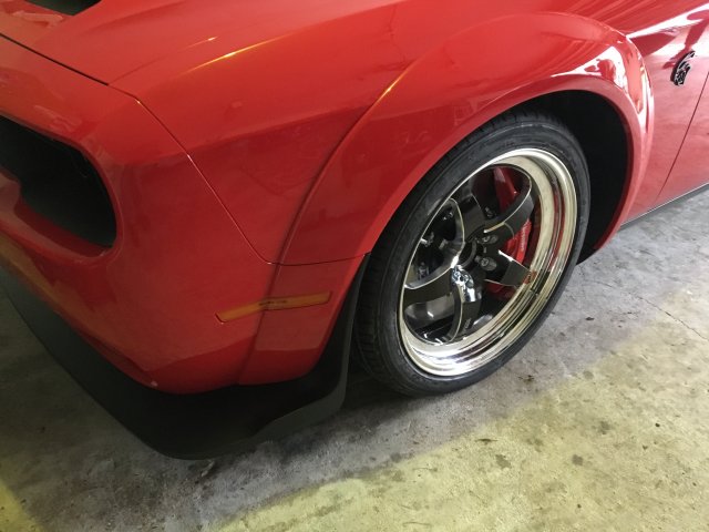

Gonna need longer front studs
20,163
Looks tight on the calipers, but I know its not. Nicely done - looks great. People will start watching out for that car.
Oh yes, it is tight on the caliper. Weld specified a 3mm spacer which I bought from ZL1addons and it barely clears.
It was way overpriced for a spacer but it looked less like an afterthought part than any others I saw.

Fwiw- I have that same rear wheel on my WBRE. We've spun them w no tire and they're both dead straight.
Also fwiw - it took a total of 4 different 315/50-17 MT's to get 2 that were round enough to balance w less than 5 ounces. They still weren't particularly round, but at least they weren't square.
I went w the 305/45-17 this go 'round. The first 2 were acceptable and each took less than 4 oz.
As was mentioned by someone else, I'd get the rims themselves spun up w no tires to be sure you're dealing w straight rims.
Did that, both wobbled.

what kind of balancer and how was it clamped?
HRJ
HRJ
#1045
478
1,043
Porsche GT3
Thread Starter #39
Hunter. Since I'm using hubcentric rings, it was balanced with a cone from the back through the center hole and a cup/spinner from the front.
Slows2k
#1475
203
253
2018 Challenger
Hunter has some lug centric adapters that may work better.
