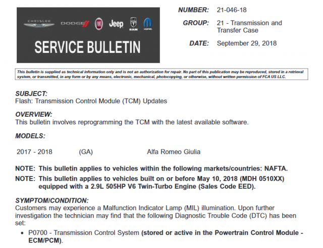

@DodgeCares
Rob, Can you get us any info on what this update provides, and when it was released?
TRANS:
21-046-18 - Flash: Transmission Control Module (TCM) Updates
TIA
Sounds great! Please feel free to keep us updated regarding your situation.
Rob
Dodge Cares
es
DodgeCares
#1299
196
Auburn Hills
2020 Challenger SXT
@DodgeCares
TRANS:
TIA
es
We are happy to help! I have attached TSB 21-046-18 below.
Rob
Dodge Cares
