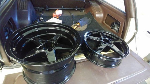

Current mods waiting for the car (or on order) are 17x11 (widebody spec) and 18x5 Racestars, M&H 325/45R17s, a Barton Pistol Grip shifter, and some catch cans.

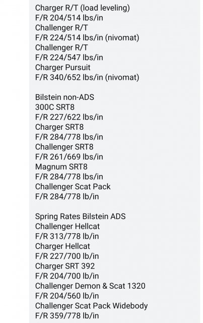

Spring rates, sway bars, and shock design are a big deal in managing a tubby machine. Dodge gets this with their factory suspension tuning. Note the change between the standard HC and the Scat Pack widebody spring rates in the back - there was obviously something to be gained there (especially compensating for the SPWB's hollow sway bars; lighter yes but offering a lower rate). Keep in mind that the SPWB has less sprung mass to control so the HCs big spring/big bar vs. SPWB big spring/biggish bar combo is probably nullified in this situation. Note, there are no comparable lap times offered up by Dodge between the HCWB and SPWB for a reason - the difference is marginal at best.

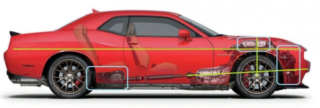

Here is a fun little exercise when choosing an autocross car: Looking at where is everything placed in the chassis.
1. The relationship between the forward most cylinder and the centreline of the front axle. Obviously anything forward of the axle centerline is a disadvantage (and contributes to the 57/43 weight distribution problem). The green lines show the relative location of the top of the engine (noting that in blue the supercharger adds about ~70lbs on top of the engine and forward in the core support);
2. Estimating the centre of gravity. Visually speaking the driveline assembly sits reasonably low in the chassis - and a lot of it is sprung mass. I'll have to revisit this later; and
3. Balance. I find it interesting that the fuel tank(s) are forward of the rear axle assembly and not hanging way out back like most of the cars I am used to. Definitely one of those times where keep the tank full may have its advantages when tossing the car around. But, I can tell why people throw weight in the trunks of these things for traction in a straight line.
