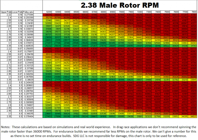

If your pulleys are the kind you can swap I'd take a 2.75, 2.65, and 2.57 to the track. Make some passes and you'll know what is working best for your setup.
Keep this in mind for rotor speed, I'm sure you've seen it before. Jesse at SDG who seemed to know his stuff didn't think super duper bearing upgrades got you much. I think it's more deflection in the rotor that causes failure. He said he'd not seen a bearing fail if I remember our convo correctly.
IMO you'd be better to free up the blower with a billet end plate so the supercharger isn't working as hard, and use a larger pulley to keep temps as low as possible. The billet end plate on mine gave me what I think was an extra 2psi. The 2.85 pulley on my 2.7 was seeing over 20psi.

What’s the stock lower pulley ratio?edit: 8.18
I’m going to do a max effort kong port with race bearing rebuild, it has been decided. Will move the a 2.57 as well most likely and see how cool it stays
