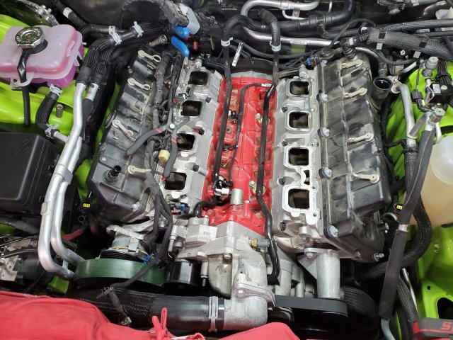

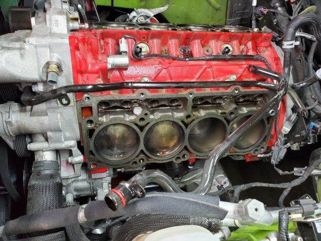

Hi I need help please I purchased a 19 challenger redeye 15,000 miles and it had a valve train noise. I had it for months and bringing it to dealerships and finally found one I trust to work on it. They removed the blower and heads and changed the lifters. I got it back with new oil and parts. By the time I drove it almost 2 hrs home it was wrapping worse than I dropped it off. So I brought it back and they tore it down again to find metal particles in the upper and lower of the engine so the pulled the engine out and started following what SRT wanted and started a huge parts list new heads, crank , bearings, cam and so forth and I’m still waiting on SRT to get back to see what they are going to do. They changed people in charge of the claim. I just want to know what to do. It sucks I had the car for months put half cash down and can’t drive the car and paying payments on it and can’t even enjoy it. Is there a lawyer I can contact to make sure I get a great extended warranty on this car for the time that I own it. I won’t even put 5k miles on it a year. I find take it out in the rain and it sits in a heated and air conditioned garage. And I personalized it to me with tints vinyl and lots of other items. I’m at a loss for words. I will take any help I can get from the group please. Thank you Louie DeSiato

I’d be surprised if they put any parts in the shortblock, I see a new longblock in your future.

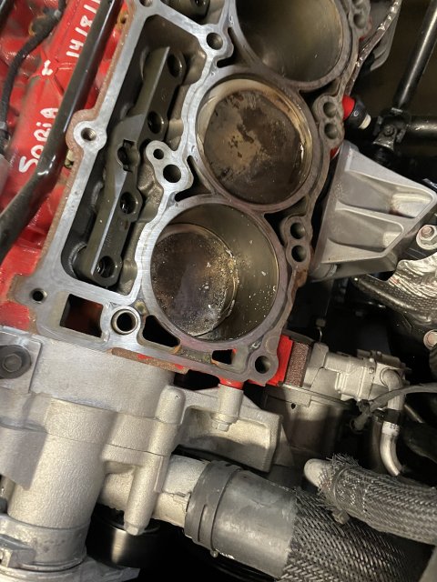

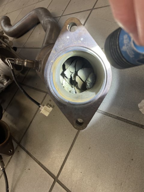

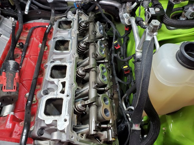

Op I saw one like that in May. SC failure and converter failure (have them inspect BOTH converters). 32CECA70-1691-4E19-B6ED-825D9A92453F.jpeg 809A2E03-51AE-43D9-A1D7-6030E80785FF.jpeg

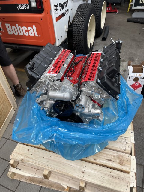

THE SOLUTION? Long block plus, SC, plus converters, plus cooling systems! 26 calendar days, cannot be more happy.
IT IS THE DEALER!!! They make it happen, or not IMO.

The new motor looks beautiful

Runs like it looks too. UNLIKE its predecessor.

That is georgus. Hope it runs better than it looks cause it looks great. Good job.
MF runs like it looks finally(y);)
