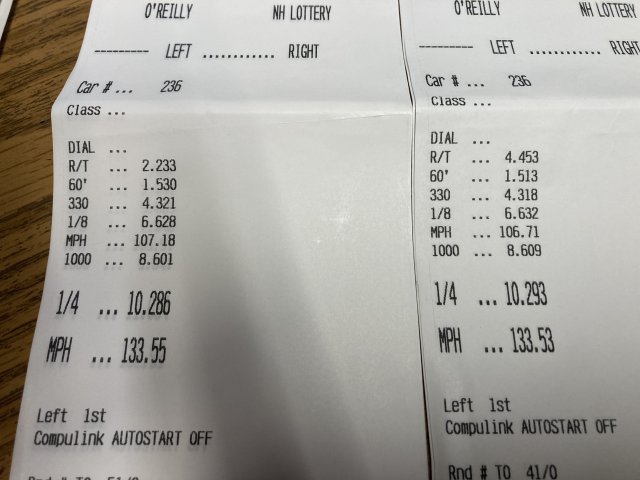

Hopefully doing a few more things by the time it gets cooler out. 9.5 or better is the goal

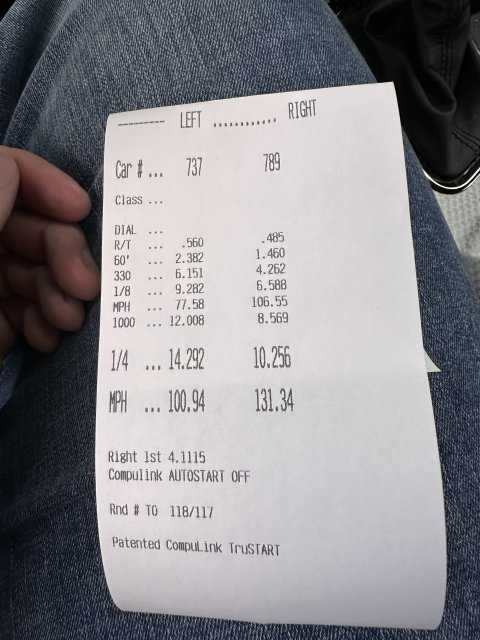

I was achieving consistent 1.4x 60 foots in Go Man Go but it took me years to get it dialed in.

Those are nice times. The best I’ve ever cut was a 1.46, with launch control of course.
