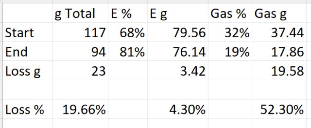

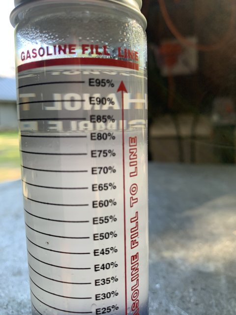

I would have thought the E would have evaporated faster!

That's interesting. Kinda how alcohol and water chemically bond and 1 gallon of water and 1 gallon of ETOH doesn't equal 2 gallons of liquid.

I’ve never noticed that in my E before.

Yeah Ive left the same E in mine for a month and content didn't change. Seems itd be hard to evaporate in a sealed system?

Yea, it would be hard to evaporate in a sealed system. If the fuel is the same and the content gauge is reading higher, it's more likely absorbing water somehow.

Yep, I'm familiar with what you're describing. Still, I've not seen my E content change on a tank of fuel once it settles. I don't make it a habit of leaving E in the tank for long periods, but I did go a month before on the same tank and zero change in E readout. Went from near full to near empty over the course of a month.
