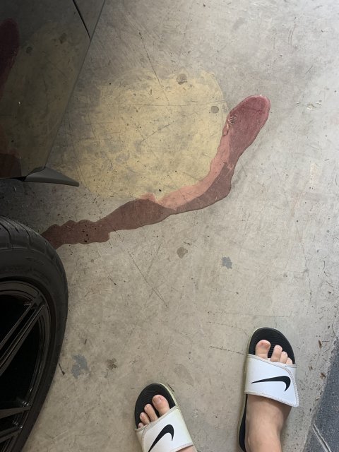

I’m definitely going to hit up the forums. Tested to see what happens at idle. Definitely hit overflow...
You would think the fans would turn on high blast in that situation. Log says otherwise... also know the t-stat opened as the hose had pressure and was not fungible when trying to squeeze it.

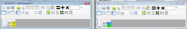

100% correct. I was tuning as if this was still a ScatPack, the changes you make in the High/Low/A/C On modes are for non PWM fans, i.e. 2 spd, 3spd or otherwise fans. You have to modify the PWM Desired ECT values. Went for a spinaroonie with the tables set and I didn't see a temp above 192 with spirited driving. Was a beautiful sight. Should help out a lot at the tracks.

Did you only change the Desired ECT table with the two temperature parameters or did you also keep the high/medium/low fan speed settings too?
Thanks!

2016 Dodge Durango R/T (PWM Linear Fan Type). Same as your SRT.
so you only need to touch the desired ect table
