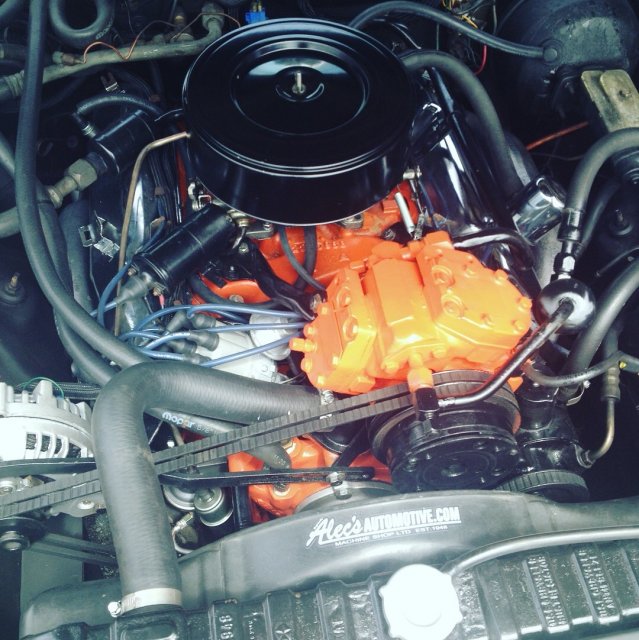

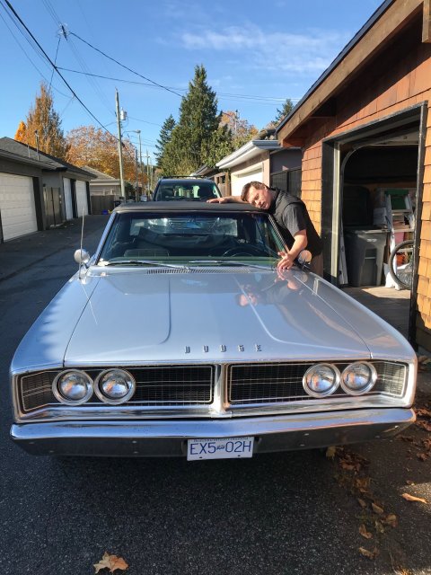

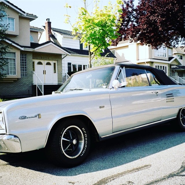

Hey all. I got a message from my sister. Her good friend’s husband died and left behind this car. Not a happy scene as we are talking about folks in late 40’s here. Of course between her and my sister, details are few. Coronet 500, 383, air cond….these are the only details I could glean from the pics. I don’t even know what year it is. The widow needs the cash, but I don’t want to see her ripped off. My thoughts are that a convertible with AC might be rare.
I have asked my sister to get her friend to dig into her husband’s paperwork as the value may depend greatly if this is numbers matching and all that….so as I get more info I will add it here. I figured with the wealth of Mopar knowledge on this site, we might come up with a number. Car is in Vancouver Canada. Thanks for any insight gang!

Maybe talk to alecsautomotive.com showing on the sticker... if that's the shop that worked on it they may have more information about it.

It will have some nice value if it’s an original 383 HP with air. Need to know the first 5 of the VIN to tell what motor it came with. Maybe Alexsautomotive.com may have some info on the motor? It’s definitely been out of the car and probably been rebuilt. Original motor would not be orange.

Looks like a 1966. I see HP exhaust manifolds and a four-barrel so it might be a factory 383 hipo engine car. The A/C compressor should not be orange, black is correct. I wouldn't know a precise value, but if it's as nice as the photos and has the original drivetrain it should bring strong money for that model.

So some internet searching has turned up 2 convertibles with asking prices around $53,000 USD. Does this seem low or high?

Seems high for that model but it looks to be in very nice condition. The only detraction is the engine and A/C compressor being painted orange. A buyer would want to know if the car has a fender tag, is it the original color and drivetrain and is it rust free as it looks in the photos? Convertibles are notorious for rust in the lower front quarter panels and trunk floor. Any original documentation would add some value.
