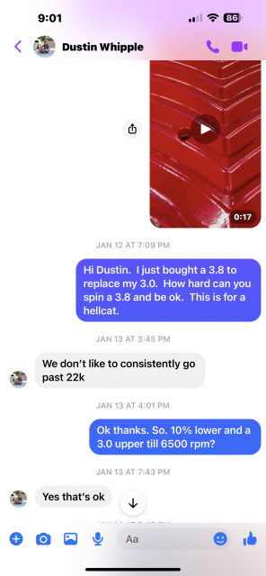

Right. I lost track that you were temporarily going with the stock block. I remember you saying that now. I’m talking to too many people about stuff. The 4.0 is a good choice then. Adam had a conversation with Whipple about my reliability concerns due to all the chatter and I was told that the 3.8 can have a problem with rotor deflection due to the larger size. It is not designed to be a high rpm blower. 18k for reliability and max of 21k for racing (“pushing it”). We were using the 3.5 (within those limits) at Houston last year and the performance was astounding with no damage to the blower. Just something to keep in mind for later.
That is definitely good to know, I think with how efficient it is I probably would never need to lean on it super hard anyways. You've already proven just how powerful it can be even with a relatively tame pulley combo.

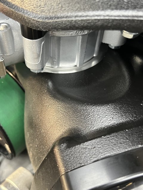

I took the blower lid off the Whipple today and noticed that the O-ring for the bypass valve was just sitting on top of the snout against the bypass valve, instead of being in the groove where it is supposed to be.
I got that sorted out and the car seems to run better and pull harder. I imagine it would have created a vacuum leak but based on where it is I’m not sure how much it would affect things.
I won’t know until I get to the track again if that makes it any quicker. The big issue I’m having is the car won’t 60 foot. It’s in the mid 1.5s and doesn’t feel like any power comes on until third.

My 60’ should be a lot better next time out. Have a few things to try and installing an ice tank to take care of IATs. If the bypass wasn’t sealing you definitely had a boost leak
Mentally this is one I'm struggling with, the car feels and runs a lot better under normal driving now. But under WOT when the bypass valve closes would it have a boost leak from there? I can see that it could still leak from the snout, but I'm not so sure about having a boost leak from the blowoff coming from the blower lid at that point with the bypass closed.
Maybe I'm looking at it wrong and over complicating it in my head.

I’d think you’d be sucking in unmetered air. Did you get logs? Your tuner should be able to spot it
